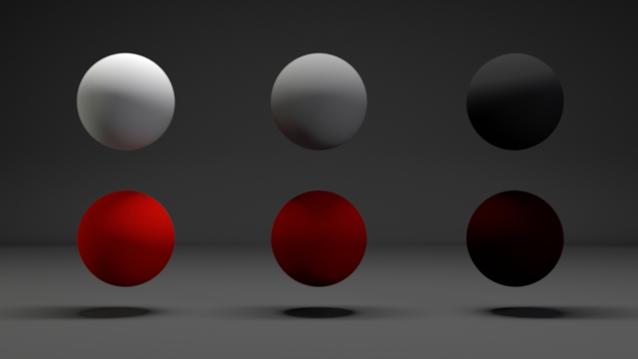

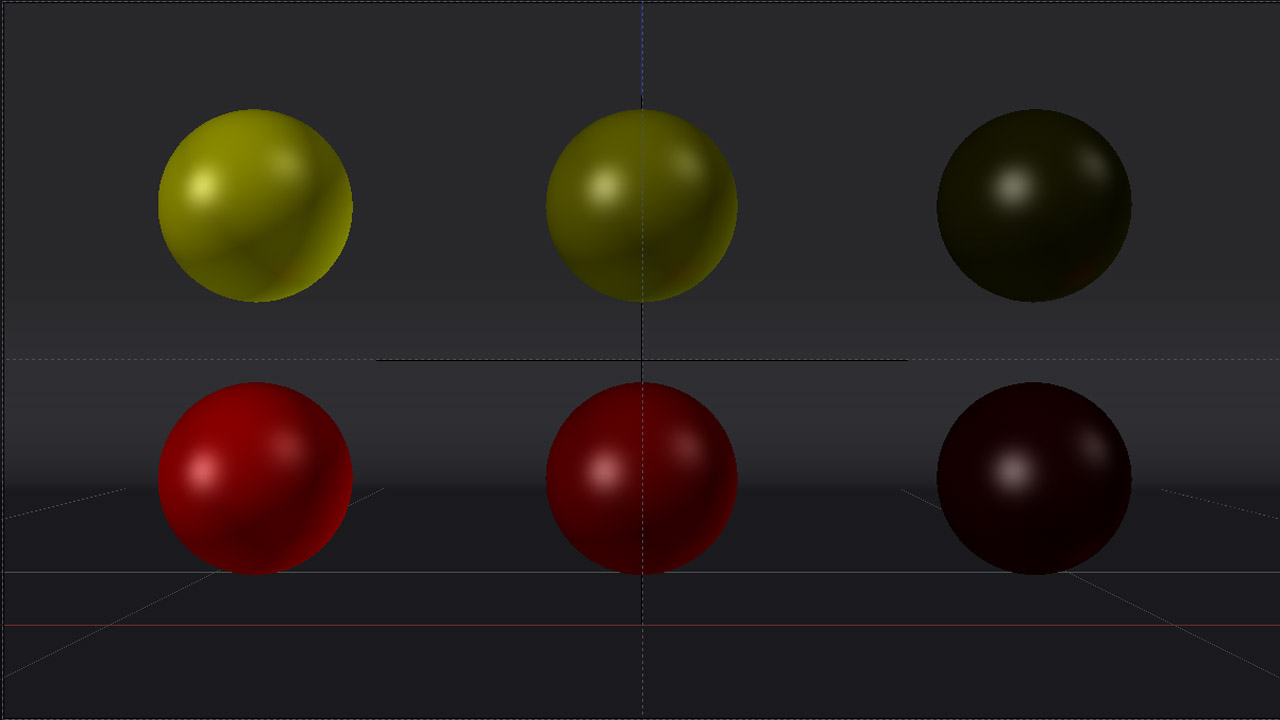

a couple tiny things that I've been hoping to see fixed (I've asked about them in the past):
RGB albedo values are exported using a default gamma of 1.0, but that results in washed-out color in the render. with every new Blendigo version I go into 'spectra.py' with my text editor and switch the default RGB gamma to 2.2 which gives me the expected color in relation to the Blender interface. might be helpful to have an option to choose RGB gamma in the Blendigo UI?
the other thing is the missing support for indigo sphere primitives. we used to be able to name an object ".sphere" and it would generate a perfect sphere primitive instead of a mesh. but this doesn't work currently. I have a number of scenes where I would use this if we had it back.
thanks for all the hard work!
Re: Blendigo (for Blender 2.63) 3.4.8.1
Simply changing gamma to 2.2 is wrong, as 1.0 gamma matches textures pretty well except in darker colors.
Try looking at the hex color in blender and comparing that with a texture with the same hex number.
Ideally blendigo should convert blender colors and export as 2.2 gamma to match textures 100%.
Oh bummer. I think that MtI is exporting colors at the declared screen gamma (usually 2.2).
Thank you for pointing out dag, and everyone please remember that I loath texels
Well, Maya and Blender may have different color systems.
Blendigo just reads the color currently set in blender and exports as gamma 1.0.
FakeShamus
- Posts: 512
- Joined: Wed May 02, 2007 11:34 am

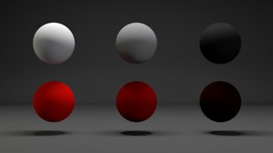

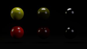

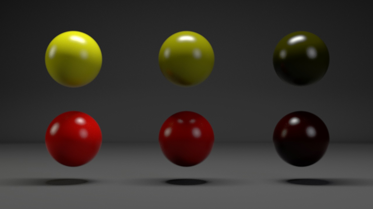

I see what you mean, but here's what I'm talking about (attached images) - this might be due to Blender's color pipeline, but adjusting Blendigo's default gamma setting to 2.2 (within the spectra.py file) get's me much closer to what I'm seeing in the viewport before export. I'm not expecting a perfect match, of course, but the colors in the gamma 1.0 version are just not very close...
What kind of tone mapping are you using?
That's not what it looks like to me.
FakeShamus
- Posts: 512

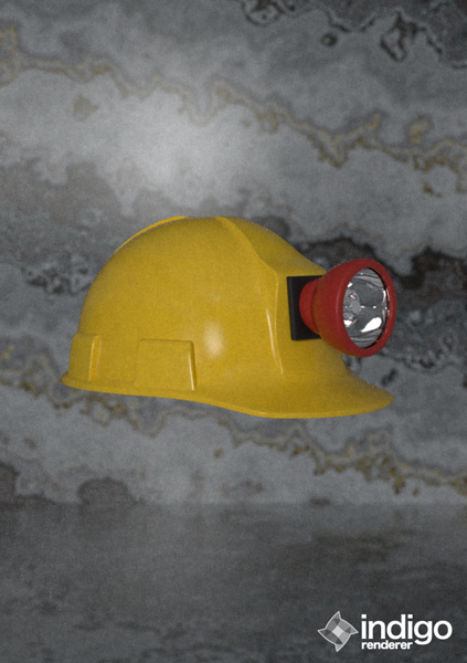

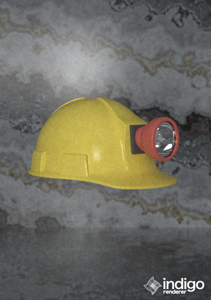

just linear tonemapping.
the background is a marble using an image texture with gamma 2.2 - and that color looks as expected to me.
