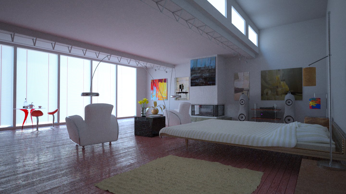

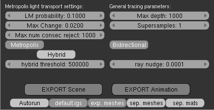

Post by pxl666 » Tue Feb 19, 2008 8:27 pm
hey
this is cooking for 9 hrs on three dualcore (2ghz) machines and its till noisy...here are my setts and render - any hints how to spedup next render of this bedroom??
cheers
ps(windows are covered with EP's)
