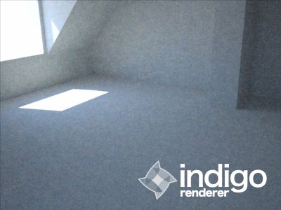

Post by Labello » Tue Feb 19, 2008 6:27 am
Thanks a lot psor! that is great! *saves the images* :D
but i still didn get rid of the issue.
i completely remodeled the room. i started with a cube. the first thing i did after creating the cube was flipping its normals. is there any possibility to show the normals in blender? i dont see any difference between different normaldirections.
i attaced the new scene again.
manu_zimmer.blend.zip
(43.45 KiB) Downloaded 279 times

@Labello
You're very welcome! I checked your new scene and can't find big issues.
If I do render it with your settings I get ~20k s/s which is ok for this
kinda scene. The default Indigo settings are way off tho. Dunno if
blendigo comes like this, but it's bad!
Change the render settings from:
LM probability: 0.1
Max Change: 0.02
Max num consec reject: 100
to:
LM probability: 0.4
Max Change: 0.01
Max num consec reject: 1000
I did also change your shader settings from 0.9 to 0.8 which should be
better. You can use biPT for quick previews and for final renderings biMLT
for this kinda scenes.
With all those tweaks I get ~33k s/s with biMLT.
And I just want to mention that you can keep the way you did your
exit portals in the last version. It's enough to have a simple plane
as exit portal, there is no need for a box. It is just important that
all openings get covered. When I say covered I mean that the exit
portal should slightly intersect with the frame of the window to make
sure that there is no spacing.
nb: For tone mapping you should save the IGI file, then open
it in Violet and color correct your image there. Don't bother to much
to make it right when you do render, do that in post.
@SmartDen
Why do you use settings like the above as default in blendigo?
take care
psor

Post by Labello » Tue Feb 19, 2008 7:27 am
OK guys!
now it works nice!
does it take any positive effect if i bevel all edges in the room to scatter the light a bit more smooth?

psor
Posts: 1295
Post by psor » Tue Feb 19, 2008 7:55 am
Mach dir keine Sorgen Labello ... der SmartDen ist'n "Netter"! ;o))
And yes bevel the edges, but not to scatter light but to make the
scene look more realistic, as you might know there are no sharp
edges in a room! In general it's good to bevel everything. :D ;)
take care
psor
