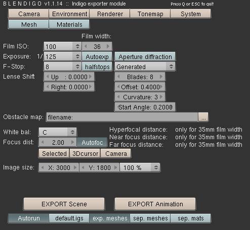

Post by isabelp1 » Mon Mar 09, 2009 11:10 pm
Well..
here's the blendigo screenshot
isabelp1
Posts: 36
Joined: Thu Feb 08, 2007 3:59 am
Location: Italy
Post by isabelp1 » Mon Mar 09, 2009 11:11 pm
continue

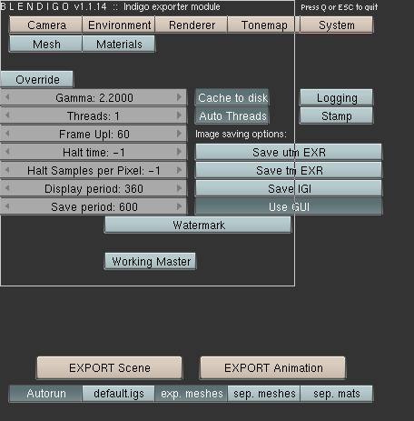

Post by isabelp1 » Mon Mar 09, 2009 11:12 pm
continue

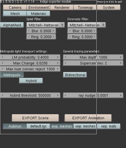

Post by isabelp1 » Mon Mar 09, 2009 11:16 pm
continue

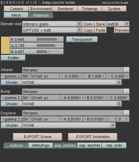

Post by isabelp1 » Mon Mar 09, 2009 11:18 pm
material..

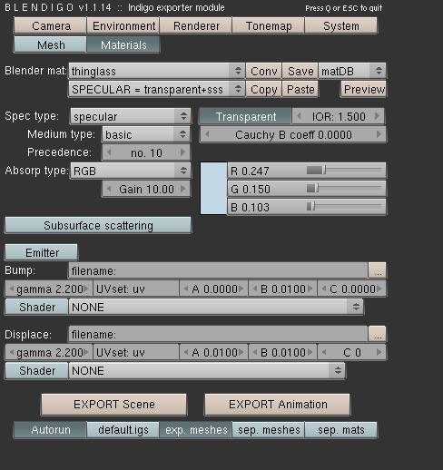

Post by isabelp1 » Mon Mar 09, 2009 11:20 pm
material..
Post by Kram1032 » Tue Mar 10, 2009 4:14 am
on the window material: Glass rarely absorbs that strong... It HAS absorption, but not that much... additionally, if you look on a window from the side (which of course only wors, if hte glass isn't yet built in), you'll notice, the glass doesn't look bluish but rather greenish...
lower your gain to 0.1 or something for now...
also the yellow wall material is too saturate, usually, though that might work ;)
Indigo only needs tiny bits of colour to get what you want. It's very good on that ;) - most of your comic look probably comes from oversaturation...
how did you do that sky? is it a plane with texture? The sky colour is too saturate as well ;)

another questions.. how can i have glass window with appropriate riflection? the material it's ok??
thanks
Post by Borgleader » Tue Mar 10, 2009 4:46 am
For one id suggest following all the suggestions Kram made and also, replace your sky plan with an env map. you can find quite a few on the internet, mainly here:
http://www.evermotion.org/index.php?unf ... =exclusive
Post by Kram1032 » Tue Mar 10, 2009 8:47 am
the reflections on your glass should be just right. Reflections are controlled by IoR (brightness of the reflection) and Expoinent (Sharpness)... In case of standard Specular, the Exponent falls appart and you get infinitely sharp reflections ;)
The problem about reflections is probably a combination of the too absorbing glass material (as said, lower the gain and change the colour to greenImage) and bad angle (only the probably pretty uniform sky probably gets reflected ;))
The green glass in the image probably is "too green", as it's, well, GREEN glass and not clear one, though, basically it has the colour you want but you need far lower gain. Gain basically controls the "strenght" of the absorption.
