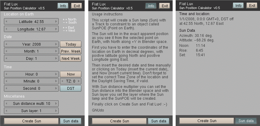

I think it is simple to understand the various parameters required, but I attached an image showing the script screenshots, including usage instructions.

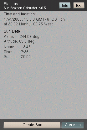

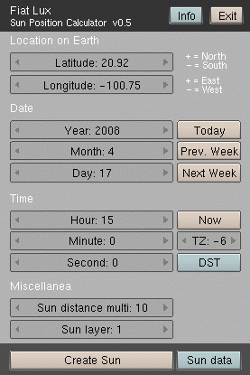

@joegiampaoli:
Do you mean "San Miguel de Allende-MEXICO" (20.92 N, 100.75 W) for your location?
Are you sure you entered all the required data (Latitude, Longitude, Date, Time, Timezone, DST)?
With the data shown in pic1, I get the Sun high on the horizon (see Altitude in pic2).

joegiampaoli
Posts: 837
Post by joegiampaoli » Fri Apr 18, 2008 8:31 pm
GNUdo
Sorry I was enterning the west value wrong it was negative
Working well
Thx :D
