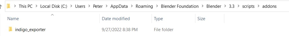

If you are working on a Windows computer, Blendigo is located in your user directory.
Obviously you'll have to replace my user name with yours ;-)

Unzip that file and in the "Sources" folder you'll find the same "Indigo_exporter" folder.
Simply move the folder and its contents into the aforementioned user directory and start Blender.
