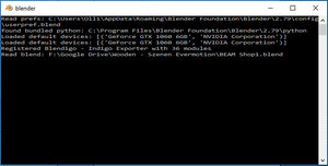

I have Blender 2.79 installed and the new Blendigo, whenever I try to render it says "name os is not defined", and the Indigo doesn't start - what am I doing wrong?

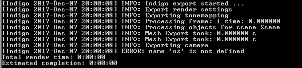

I get the same error as Polinalkrimizei reports.
Couldn't find the culprit :?
It's an older test scene. Cube, plane, sun/sky & camera.
Newly made works fine.
Errror:

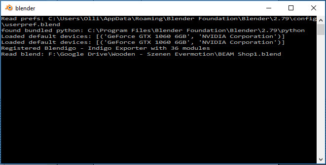

I deleted the indigo_exporter directory and installed it again. I tried the 2.79-folder in the App Data folder, as well as the Program-Folder, where Blender is located. I always get the same error, the scene was working well before. A screencap of the console is attached.
Thanks!!

@Polinalkrimizei, @burnin, I think I fixed your error. Code is here https://github.com/glaretechnologies/blendigo
burnin, your scene was really helpful :)

Confirming, error is resolved.
Thank you.
