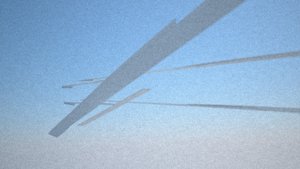

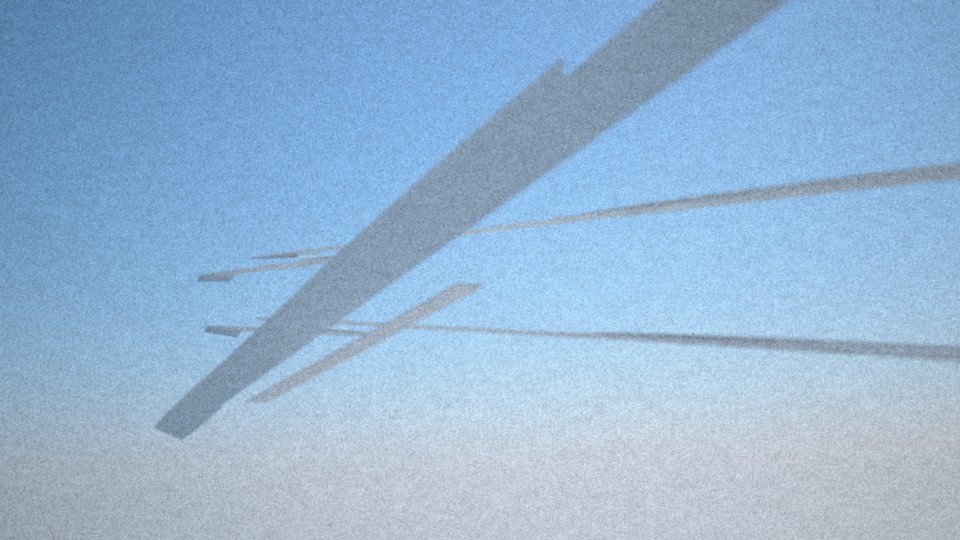

Re: Blendigo (for Blender 2.6x) 3.2.6.0
Hi all,
There is a problem exporting curve modifed mesh.
I use last indigo 3.2.8
