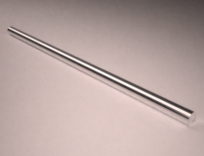

How do make reflections like this?
12 posts • Page 1 of 1
JDA
Posts: 30
Joined: Tue Mar 25, 2008 1:44 am
Post by JDA » Sat Apr 05, 2008 11:06 am
Reflection Example
Behrendt
Posts: 255
Location: Cologne, Germany
Post by Behrendt » Sat Apr 05, 2008 12:13 pm
Nothing special about it I guess. Just a studio-setup with a simple ligh-plane ligting the scene. Just try tu put a plane as a mesh-light at a position behind your camera and with a nice angle to your object and you should get similar results. :wink:

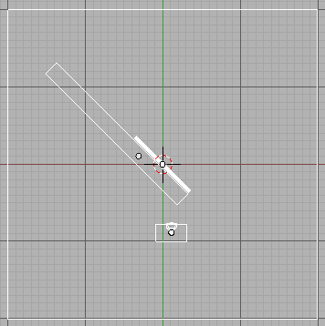

Post by Behrendt » Sun Apr 06, 2008 12:45 am
Here you go, not exactly what you wanted, but had no time to test more. You'll see - it's just about the arangement of the light-planes, because it's of course the enviroment you see in the reflection.

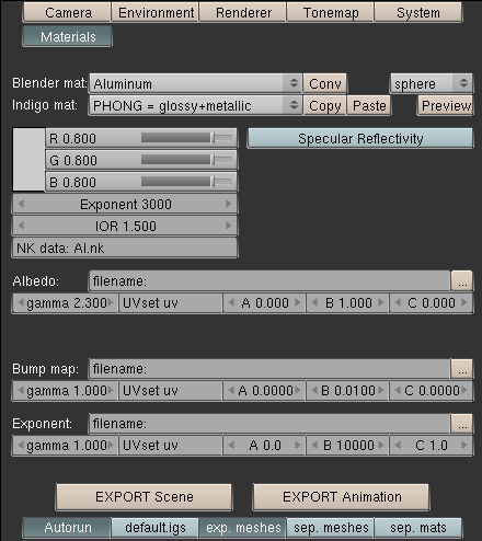

Are you sure you're using the good material, becaude in our picture you linked, this is a studio setup with one plane or two to illuminate the scene :roll:
What is your metal, have you got a screenshot for us?

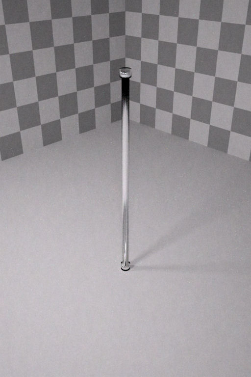

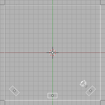

Post by JDA » Sun Apr 06, 2008 7:26 am
I am using a NK Data file Al.nk (Aluminum).
Render.
Material.
Studio setup.
Post by Zom-B » Sun Apr 06, 2008 7:43 am
check your normals dude, they should face outwards.
Deaktivate normal smoothing for this hard edges, or subdivide these edges to a (very small) round bevel...
Post by Kram1032 » Sun Apr 06, 2008 9:56 am
...Or as it's in blender, use the edgesplit modifier ;)

Here is my lastest test.
I had to add an emitter plane x2 + 1/3 longer
then the cylinder to get it to look right.
Render
Studio setup.
Post by Kram1032 » Sun Apr 06, 2008 10:06 am
Even if it's just a quick test: The edgesplit modifier gets rid of all your normalsmoothing problems ;) It splits edges, where the angle of the normals would be too small to look right. you should always use it, no matter if you use Indigo or Blender Internal - though *definitely* use it with Indigo ;) (especially where you have very sharp edges, like in that stick with it's 90° edge)
