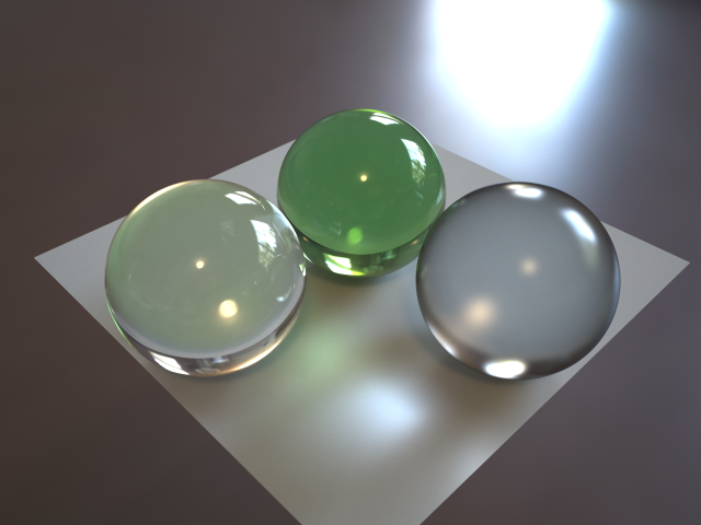

Post by Zom-B » Sat Sep 08, 2007 10:32 pm
Kram1032 wrote:@ zsouthboy: cool bulb :D but I think, he talked about a white ("frosted") bulb...
maybe, glossy transparent with low exponent problems?
yep.... the only Problem with "black glass" I know seems to appear for glossy transparent mats... here an example (grey one):

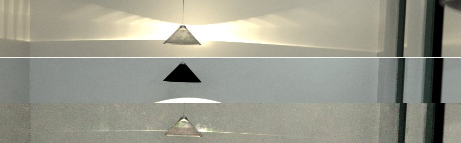

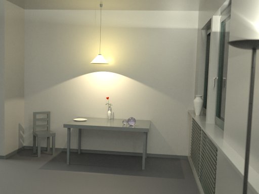

It's a bit fake maybe, but I used a transparent diffuse, and it works quite well, see the lampshade.. (idea for the room shamelessly stolen from -- eh, I can't find the originating image anymore, take credit, everyone;))
I did too try to get it working with sss materials, results see below;p

about the lampshade: it needs far longer to render, I bet, but the SSSversion looks best :)
