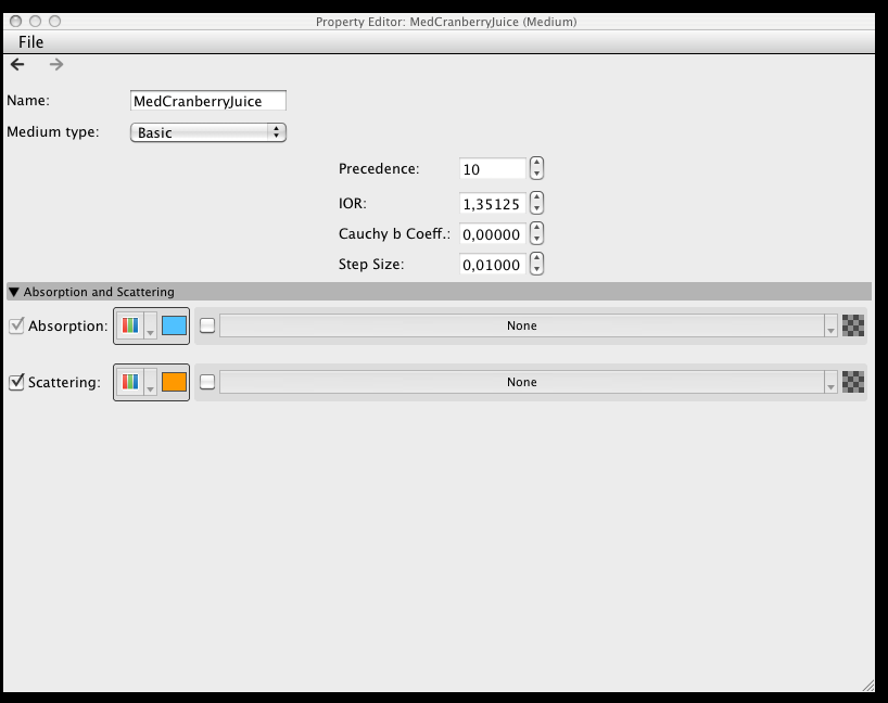

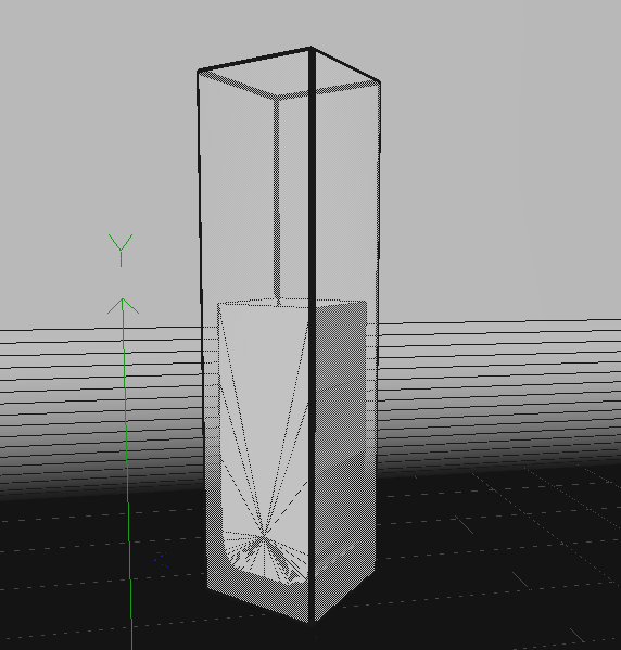

I wish I make a container of liquid.
When I apply my liquid + glass materials (see material parameters), the liquid appears black. But I checked the normals, everything seems correct.
would anyone have an idea?

Post by Zom-B » Wed Mar 13, 2013 1:51 pm
check page 115 of the "Indigo Technical Reference.pdf" inside your Indigo installation folder :)

Post by galinette » Wed Mar 13, 2013 8:24 pm
Maybe your juice medium is absorbing too much, or maybe the object dimensions are too large. Remember that Indigo unit is meters, and that 2m thick of cranberry juice looks black

Post by Zom-B » Wed Mar 13, 2013 8:28 pm
For sure the glass Precedence value must be at least 1 point higher then the one of the fluid, otherwise strange stuff can happen ;)
