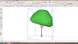

Well , for sure there is something with the exporter , i am a SketchUp user ( Skindigo ) and this is what i get:

Re: Laubwerk Threes Support ?
Post by yonosoy » Fri Jun 01, 2018 6:27 am
Search "Render mode" inside the tree definition and set the value to "Complete geometry".
Seems that actually you are rendering the convex hull.
Hope this help.

Post by Lal-O » Fri Jun 01, 2018 6:55 am
Thank you once again for the suggestion , but it seems that option is not available in the Laubwerk version for SketchUp. SU has a major problem by handling high poly models and for sure that is the reason why is not possible to show the full geometry of the models :cry:
Will see later how this ends
Regards :D
Post by yonosoy » Fri Jun 01, 2018 8:38 am
You don´t need to view the complete geometry, is only a render flag.
Is very strange that the option is not there, anywhere related with Laubwerk menus.
This made the plugin unusable... and is hard to understand.
Good luck!
Sorry, now remember that you say that works with other renderers...
so don´t know :)
