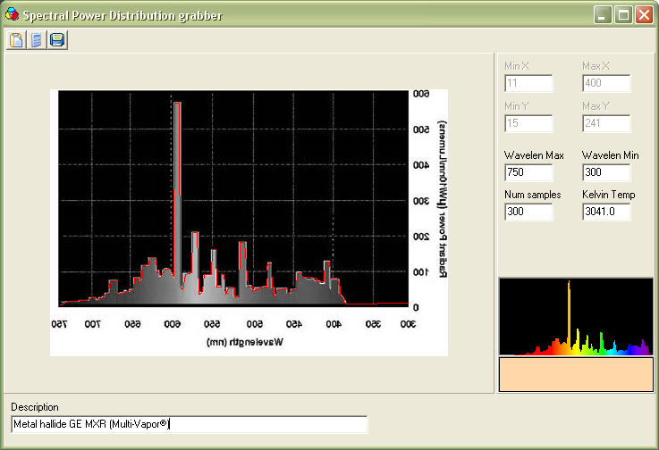

Hi, I've created an Application to extract Spectral Power Emission data from SPD images (available from ligthing producers). The Program search for a RED graph line (255,0,0), so if you have some interesting link or SPD images (better with the red line drawn), please post them.
It is very import to have the wavelengths for the image (min and max wavelength)
In the next days I will post some spectral data usable with Indigo.
Stay tuned... :wink:
P.S.
1) The image is mirrored to have higher wavelength values on the left :mrgreen:
2) The right-bottom spectrum is the evaluated curve (from 380 nm to 780 nm)

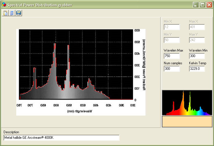

Another example (GE Arcstream® 4000K)...
