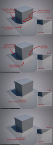

Hi guys! After a few days, I had some time to compare the efficiency of the different render methods over the same test scene.
It is very simple: a plane with a box. Only one material applied: a phong plastic. Environment is a basic sun/sky system. I rendered all these images with SS1.
I wrote down some notes I want to keep in mind for myself. Maybe these may come in handy for developers too, who knows? :wink:
Generally, I find that the GPU acceleration gives excellent results (fast and with no artifacts) in the indirectly-lit areas, but it is still a little unefficient in the reflection areas (maybe it's a PT algorithm limit..). To get an overall accurate result it is still good to stick to PT+MLT, which gives correct results and it is faster than BiDir MLT.
IMPORTANT NOTE: I am running on winXP 32bits, so these tests are useful for the users who cannot locate large amounts of RAM, so they have to keep the supersampling to 1. Probably, increasing the SS to a higher number will produce less artifacts while using the PT algorithm.

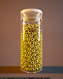

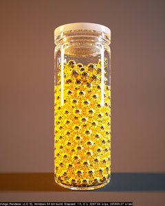

Hi, guys,
dcm wrote:thx but this so simple...try complex situation with small openings, double glass, metals etc.
I've made a simple test. Every image was rendered for 1 hour. Aperture diffraction is on and generated. MNCR is 10000, SS is 2. Two blackbody emitters from left (2500K) and right (8500K).
I was surprised a bit by the OpenCL result :P
edit: nVidia GeForce GTX 470, driver ver.: 275.33
Pathtracing
Pathtracing, MLT
Pathtracing, BiDir
Pathtracing, MLT, BiDir
Pathtracing, BiDir, Glass Acceleration
Pathtracing, MLT, BiDir, Glass Acceleration
Pathtracing GPU (CUDA)
Pathtracing GPU (OpenCL)

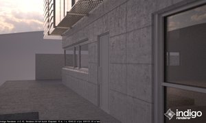

I'm testing Indigo 3.0 as well for an interior scene.
Is there no way to let the sun come through glass and using GPU acceleration ?
Or the same question in other words:
With Pathtracing there is no way to let the sun shine through the glass of a windows ?
Kind regards
Alain

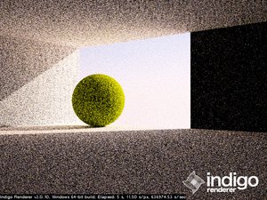

Post by PureSpider » Thu Jun 23, 2011 5:13 am
Also did a small test with pure PT with and without GPU, results attached.
CUDA enabled
No GPU

Post by Alain » Thu Jun 23, 2011 7:43 pm
My windowsglass is a volume and I use an architecture glass material.
Pathtracing doesn't let sunlight throug glass, right ?
Where is the "Glass Acceleration" feature ?
I'm using Maxigo.
Kind regards
Alain

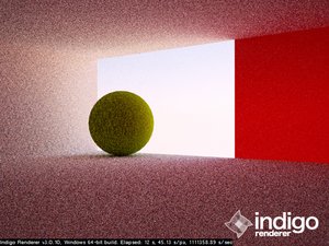

Post by Zom-B » Thu Jun 23, 2011 10:30 pm
Alain wrote:My windowsglass is a volume and I use an architecture glass material.
The "architecture glass material" is a old man made fake material that nowadays brings more problems then it helps. The idea behind it is also to put it on a single sided window (normals facing inside!) not a volume.
Create a simple specular material with a IOR of 1.52 and transparency with uniform or white absorption spectrum. That should work like a charm!
Alain wrote:Pathtracing doesn't let sunlight through glass, right ?
wrong, but it may need longer ;)
Alain wrote:Where is the "Glass Acceleration" feature ?
I'm using Maxigo.
Should be to find under "Renderer Parameters"
Re: Method comparison
Post by Headroom » Thu Jun 23, 2011 10:31 pm
All sampling algoritms in indigo ultimately converge to the same result (at least in theory), so Pathtracing does let light through windows. The images in PureSpider's post right before yours are proof of that as both use Pathtracing (with and without GPU support).
Not sure what the problem is with your scene. Perhaps may want you post your scene in the Maxigo forum so someone can look at it and analyze it. Are you sure that the surface normals of your window volume point outwards and not into the glass volume ?

Post by Alain » Thu Jun 23, 2011 11:54 pm
@ Zom-B
When you say "specular material" you mean "glass/sss" or a "phong" material ? I can't find a specular material type in Maxigo.
I tested a phong material type called "Architectural Glass - Light" which was in the presetlist of Maxigo.
But both material types do not let sunlight throug the glass. It only works when I set the opacity to zero.
What else could be wrong ?
Im testing it with this scene:
Testszene_simpel_01_236011.zip
(46.87 KiB) Downloaded 201 times
I can't find any "Glass Acceleration" setting in the Maxigo render parameters nor in the Indigo Rendersettings.
Kind regards
Alain
Post by Zom-B » Fri Jun 24, 2011 12:49 am
Alain wrote:When you say "specular material" you mean "glass/sss" or a "phong" material ? I can't find a specular material type in Maxigo.
I'm not a 3D MAX / Maxigo user, so I actually don't know the whole naming etc. but am versed in basic Indigo theory :)
It should be "glass/sss", but let the sss features disabled. The normals should point outwards of your glass mesh!
Alain wrote:I tested a phong material type called "Architectural Glass - Light" which was in the presetlist of Maxigo.
yes, as I told a old fake material... don't use it, it was nice in the "early days" of Indigo!
Alain wrote:I can't find any "Glass Acceleration" setting in the Maxigo render parameters nor in the Indigo Rendersettings.
Maybe you are not using the latest Maxigo version, it was integrated in Maxigo 2.0.6, but better use the latest Maxigo exporter from here: http://www.indigorenderer.com/forum/vie ... =9&t=10892
Alain
Posts: 101
Joined: Thu Aug 23, 2007 11:44 pm
Post by Alain » Fri Jun 24, 2011 4:49 am
OK, sunlight still doesn't come in.
I use this material settings:
Result with Pathtracing:
Result Bidirectionsal Pathtracing:
The right half (red and black one) of the windows is just a plane, the normal points inward.
The left half is a flat cube. Normals pointing away from the cube.
Both use the material above.
I want the sun coming throug the windows like in the "Bidirectional Pathtracing" but with GPU Acceleration.
Is this possible yes or no ?
Kind regards
Alain
