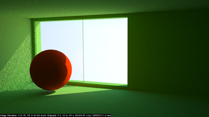

As stated before, all tracing methods ultimately converge to the same end result. Some just take a little longer. In case of your test scenes simple path tracing is simply not a very efficient method. While the noise in most of the image clears up pretty quickly the area behind the glass appears at first to receive no direct light.
However, your test renders simply did not render long enough to determine if there actually is light getting through the glass. I recreated your scene in Blender only covering half of the opening with glass.
This is rendered with Path Tracing (non GPU as it's actually slower for this scene on my iMac). As you can see it took quite a while for anything to show up in the area in question with PT while in BIDIR it shows up immediately.
So in essence, there is nothing wrong with your scene and there's nothing wrong with Path Tracing it just takes it's time!
While a Single PT Glass Acceleration would help this scene, i'd assume a GPU supported BIDIR (perhaps also with glass acceleration) would be even more helpful.

Did it take 9h CPU computing until directlight came through the glass ?Headroom wrote:@Alain
Win 7 64 Bit, 8 GB RAM, Geforce GTX 480, Blender 2.62, Indigo RT Trial, Blendigo 3.2.12.0
Re: Method comparison
@Alain
I am not sure I understand your question. Whatever can be seen in the status line on the bottom of the image is how long it took to render that image. It rendered overnight.
IIRC in another thread it was mentioned that there is currently a bug in Pathtracing that causes this atypical behavoir. I am sure the folks at Glare are working diligently on finding this bug as it obviouslt limits the usefulness of pathtracing.
Again if you use BIDIR the direct light shows up immediately.
