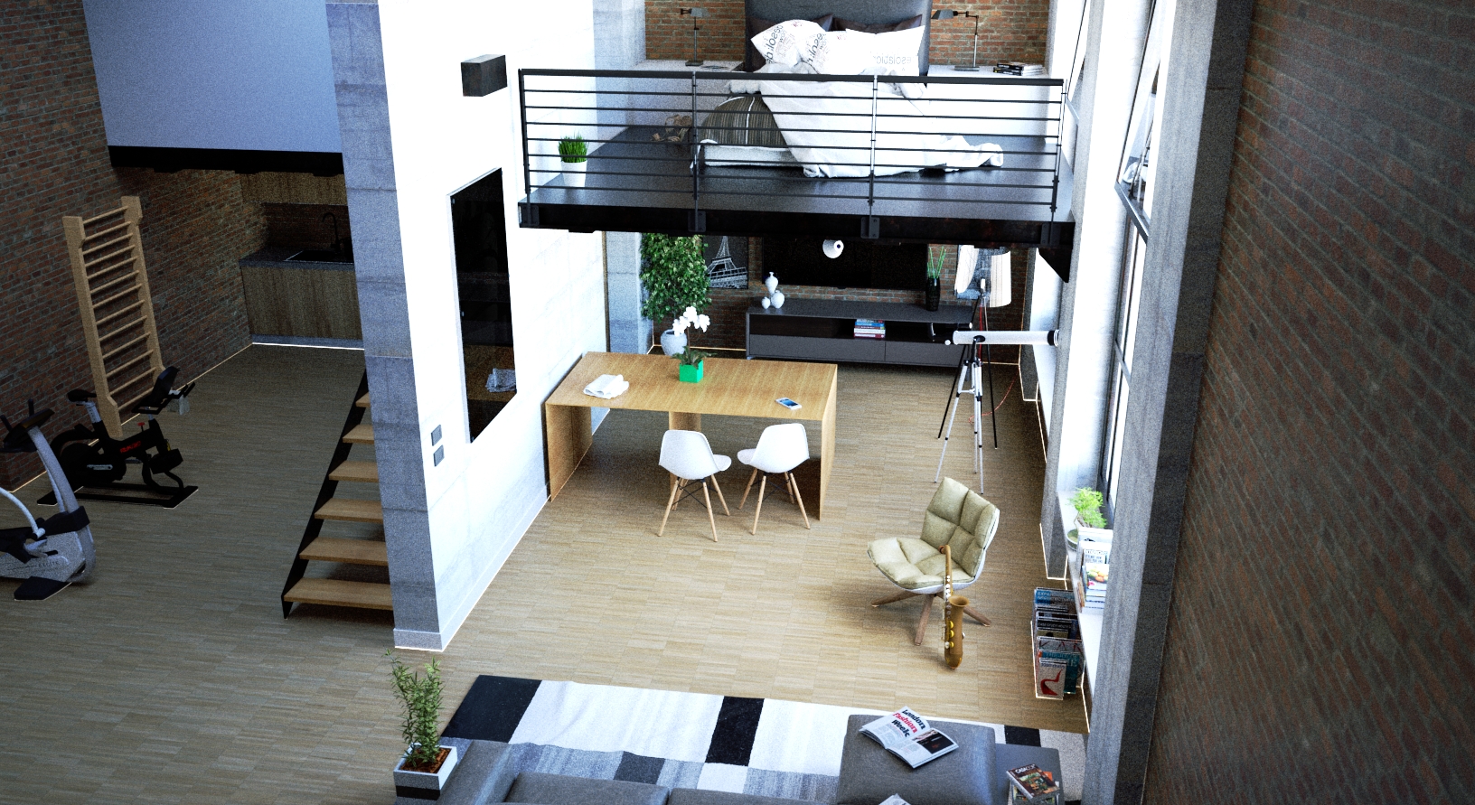

Post by Pibuz » Fri Feb 02, 2018 11:09 am
Thanks for the latest version.
I noticed there's a light leak at the base of the geometry, when using openCL rendering.
Raising the models up 1mm didn't solve the issue :roll:
Re: OpenCL, sun-sky and emitters
Post by OnoSendai » Fri Feb 02, 2018 3:01 pm
Try making the floor have thickness.
