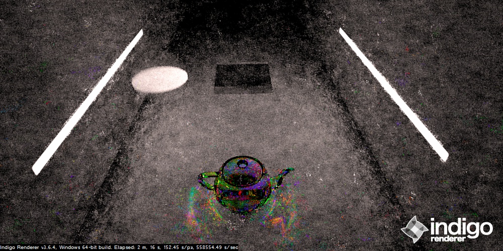

I realized now that since, don't know when, single CPU PT renders fog correctly outside and inside camera! :)
Here an example:
Now we only need that in GPU and BIDIR.
