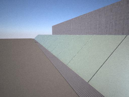

Hi,
I currently have the following issue : minimum turbidity of 2 (and fixed turbidity in the captured simulation) are maybe Ok for the UK weather, but currently in West france the sky is so clear, that the gray haze at the horizon in renders is terribly annoying.
Here is an example : picture vs render. The sky position is precisely matched ( and quite high : 25° to zenith, which caused me a terrible headache in the evening due to over-exposure to sunlight, not kidding )
Is there any way this could be improved in the future?
Etienne
Perfect west coast french summer
UK-style hazy weather in renders

Post by OnoSendai » Tue Jul 16, 2013 10:04 am
I found the same issue when matching NZ skies, as they tend to be a lot clearer than European skies.
The problem with lowering the turbidity past 2 in the old indigo sky model (smits, shirley + preetham) is that the model breaks down / blows up.

I could bake out a captured sky with lower turbidity.
At some point I could allow users to bake the skies themselves I guess. It takes quite a long time though. (an overnight job at least)
