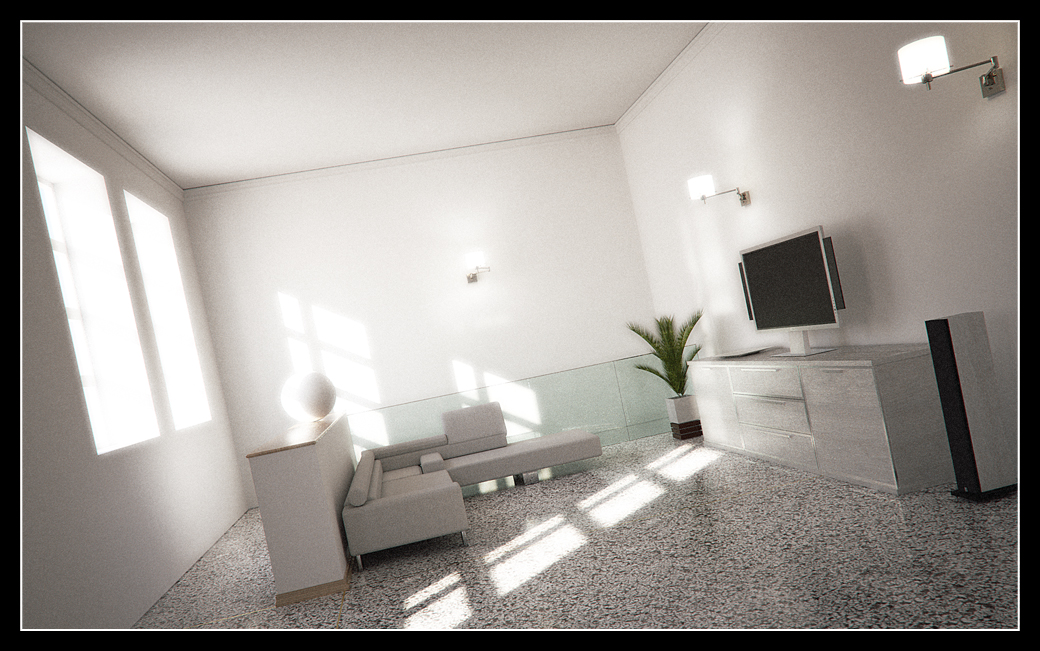

Hi all.
This is a very fast work, with simple setup and rendertime.
I recall someone asked me to make a simple scene available to study some settings, and so it is.
So, don't expect stunning results or anything. I've used only internal maps inside sketch to make it simple: no complex materials. I think I've used all kind of shaders: diffuse transmitter, glass, phongs, emitters etc.
I attach the final result too, a little photoshopped to show how image can change from the outbox render to a pseudo-final one.
One thing you have to change for sure is the path of metal shaders (nk): they refer to a specific folder inside Indigo root dir, so everyone has his own.
So, enjoy. Let me know of the problems.

1. To render this scene you only need the 1.1.18 version of Indigo and the 1.1.16 version of SkIndigo. Both of them are still free and they work pretty well (I suggest ALL SketchUp user to work with them, for they're updated with the major changes of the main features of Indigo and they're still free).
2. You get a nk error sice the path saved by Indigo and SkIndigo refers to a specific position on MY machine (that was actually pointed out by me in the first topic where i say [quoted] "One thing you have to change for sure is the path of metal shaders (nk): they refer to a specific folder inside Indigo root dir, so everyone has his own".
3. I think I used only "internal" textures to render this scene: the albedo map depends on the sketchup mat's texture (which is STORED inside sketchup), so there shouldn't be any problem with that, 'cos when you exchange a skp file all textures are preserved... Let me check this out. Perhaps, the only external map is the bump map of the floor...

Hi Snorky. Maybe you've been out for a little more than a while
In the previous versions of SkIndigo you could add a bump map only "internally", which meant that you had to create another sketch material with the bump map and then you could apply that bump map to your base material.
Now you can avoid adding almost useless materials for your additional maps, and you can directly link them to a specific folder in your hard disk (textures which are "external" to SketchUp): this to make SU files lighter.
Obviously, if a specifc mat refers to a bumpmap that's not in your pc, Indigo won't be able to render the scene correctly. This is the case of the floor mat, I think. Its bump map refers to a bump texture in my hd, but that's not present inside yours, so you won't render it correclty. Unless I give you the map and you re-specify the correct path once you have it in your hd. Got it?
