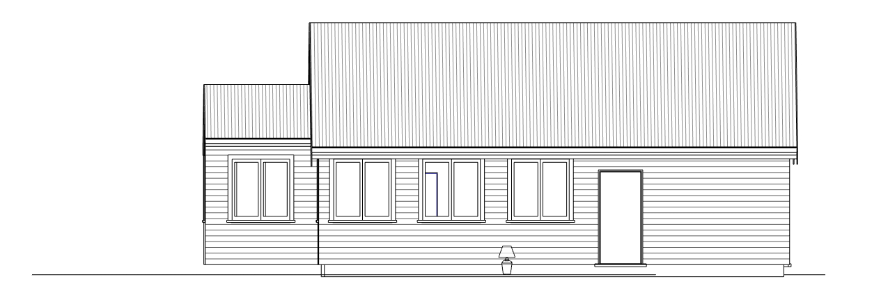

Orthographic (non perspective) views do not render in indigo:
Hidden Line view in Revit
Render view in Indigo

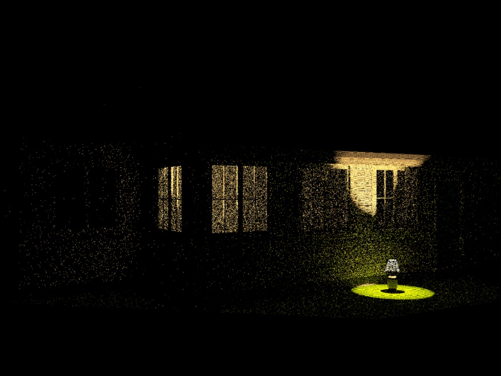

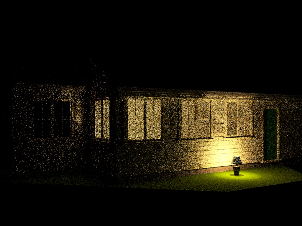

Also, another bug. Lamps render quite differently with GPU enabled
Re: Indigo for Revit 3.6.24 Beta - Revit 2014 support
Hey, did you make sure that after enabling GPU rendering you are still using the same render mode ?
E.g in the Indigo GUI , say you have Bidir MLT enabled and then switch to GPU rendering it will automatically switch the render mode to Pathtracing as that is the only render, mode that currently enjoys GPU support.
ATI Radeon HD 5750M 1024 MB
OS X 10.10.3 Yosemite
- fractal.design
- Posts: 51
- Joined: Wed Sep 08, 2010 4:38 pm
No I did not, thanks for clearing that upHeadroom wrote:Hey, did you make sure that after enabling GPU rendering you are still using the same render mode?

Hi,fractal.design wrote:Orthographic (non perspective) views do not render in indigo:
we fixed orthographic 3D views in 3.6.25:
http://www.indigorenderer.com/forum/vie ... 38&t=12694
Not entirely sure what needs to be done to support plans and elevations, but we will have a look at it.
