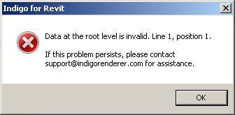

Thanks for the reply, but its still hindering due to some reasons !
Showing these error messages (images attached - message1 & messgae2 on clicking 'OK' of message1)
Kindly suggest the solution.
thanks
Sujeet

Re: How to use Indigo materials(IGM & PIGM format) in Revit?
Post by fused » Mon May 14, 2012 10:52 pm
sujeet wrote:Dear Yves
thanks
Sujeet
Hi sujeet,
which material did this happen with? Do other materials work?
Kind regards,
Yves

...its happening with all Indigo materials of any of the categories !
(ie. Blue silk, Cashew wood, Parquet etc)
