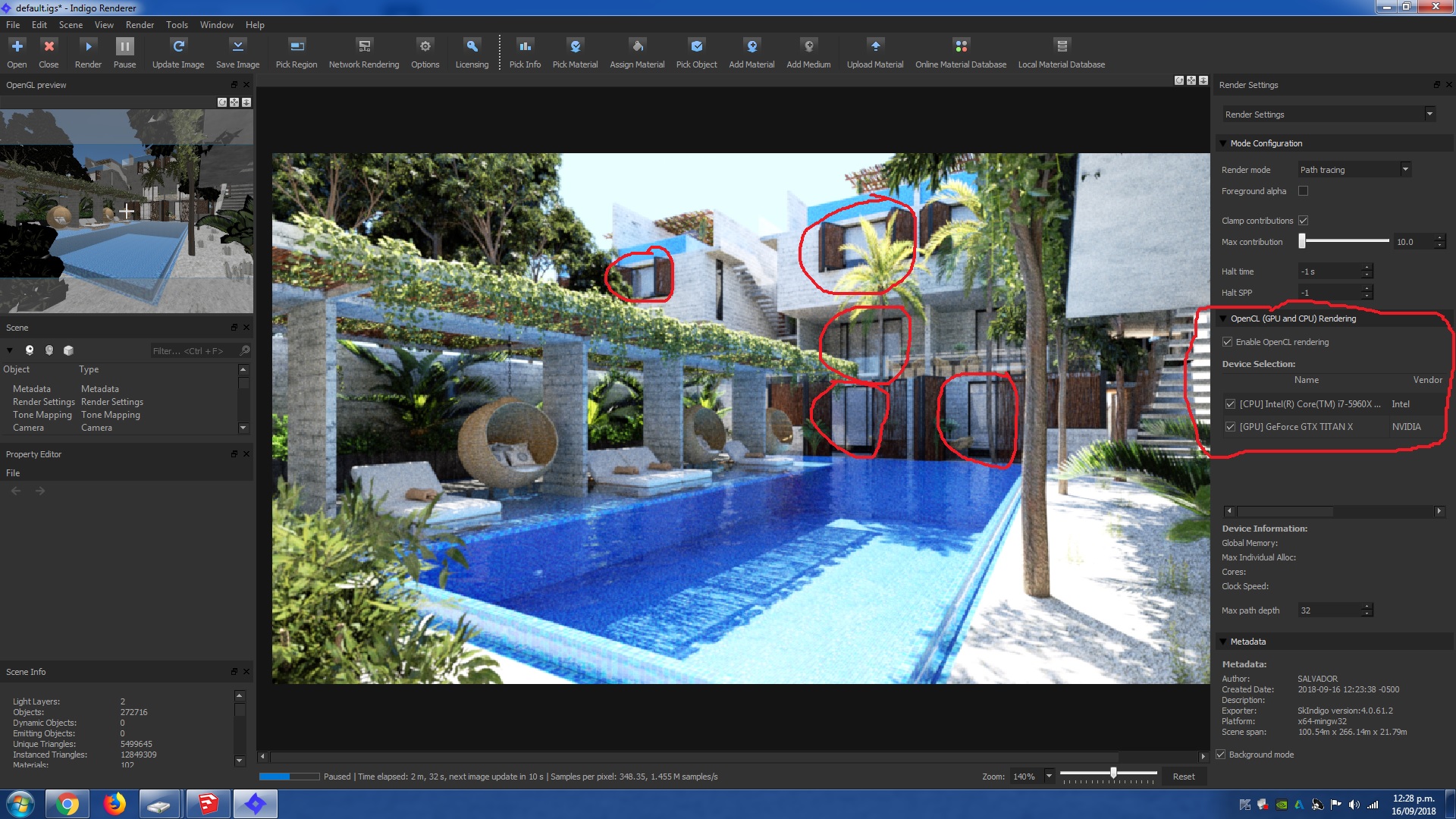

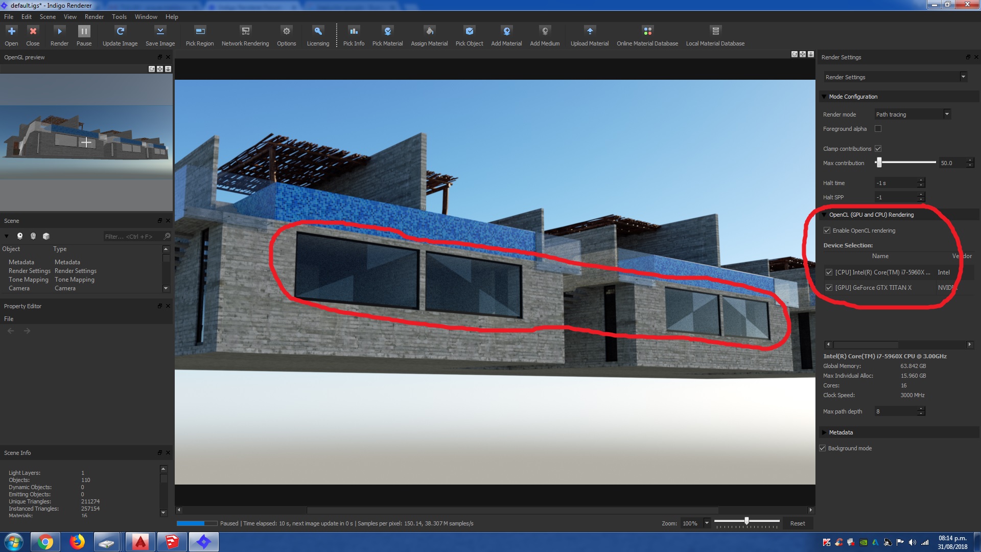

Please .This time i need your help to solve a problem with some glass panels of a project for a client that i am working on.
I've already checked my model and is fine ,i mean ...it's been modeled as always since i started to use indigo for rendering some years ago and this is the first time i face an issue with glass and Indigo. :cry:
The rendering process is fine if i keep OpenCl off, but once i enable it then this strange triangles appears.
I attach the .pigs and some screen caps just in case someone wants to take a look. :D
Thank you in advance.

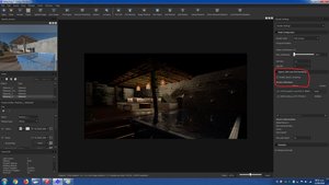

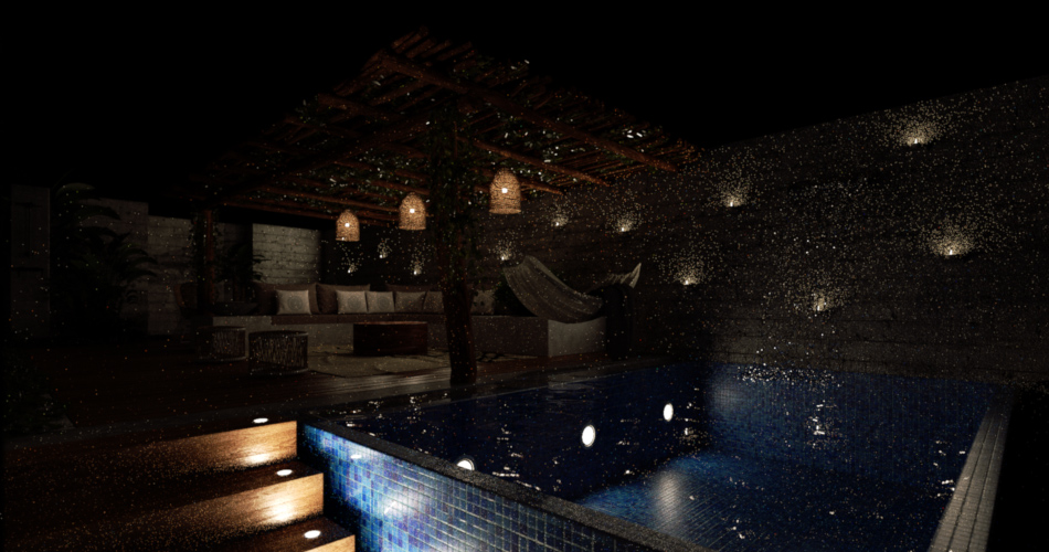

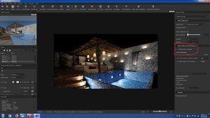

I am not able to replicate the issue anymore :roll: . But i am facing some other similar problems with other scene (A terrace). Lights seem to be "blocked" with other geometry (you can see it in the spot ligths at stair and the pool) , but they are well modeled.
I attach some screencaps and the .pigs if you want to take a look :D
Pigs Link
https://drive.google.com/open?id=1KVbkl ... _xWf_OAVow
( I've also try OpenCL with CPU Unchecked and no change).

Hey Lal-O, I finally got some time to take a look into your scene.
First of all please please with sugar on top disable the CPU in OpenCL render mode, this is slowly killing me!!1!
On my GPU the image does render different then in your GPU+CPU mode, I got expected results, noisy for the candle light because PT without BiDir hates such tiny emitter sizes:
Regarding your uploaded I file I ask myself why do you keep rendering Sun + Sky for a night scene and disable the layers then?
This still does all the calculations for Sun+Sky and slows the convergance of the whole image down.
Your scene is also very big, 3 full houses with 3 terraces and a lot of architectural stuff below it. Try to organize your scenes in a way, that you only export and render relevant areas, disable unneeded areas for export.
Your Pool Water seems to be made out of ArchGlass, this is a bad choice if you want some realistic look for that pool.

1) My CPU is Disabled everytime i use OpenCL :roll: ( i got it since the very first time you advice me to do it ).
The .pigs i've uploaded is like is because i wanted you to see if there could be any other resason of failure beside to have enabled the CPU...That's it ( a model ,bad modeling skills, etc etc).But it is always disabled (all my drivers are updated :D ).

1) In all your two examples above the CPU is clearly activated! It is the checkbox above your Titan X :lol:

This should not be the case, either you have CPU rendering enabeled as the screenshot clearly shows,
or your GPU drivers are old...

Of course CPU is enabled in the screenshot...There are reasons for it :D
1) It was the first test of the project ( almost 3 weeks ago :roll: ).Right before i knew all the useful stuff i know today :wink:
2)I've always worked with both devices enabled without any problem (I USED to belive that this would increase the rendering speed.Now i know i was wrong) and this was the very first time i had a problem on exteriors using CPU+GPU...That is why i created this post :D
3)I did change the model of the glass panels,render with OpenCL (both devices enabled) and it worked! Why? Don't know...I don't have why to lie,trust me...Indigo Renderer is my main tool of work ( Arch Viz is my side business,but at this very moment,me and my family are living of this :D ) and i want contribute to indigo gets better everyday.
4)The last thing i want is to be annoying :oops:
-Here is a proof of the point 3-
My final conclusions:
OpenCL -CPU+GPU Enabled- Sometimes work, some others doesn't
OpenCL -GPU enabled- Always works so ... why take risks? :D
