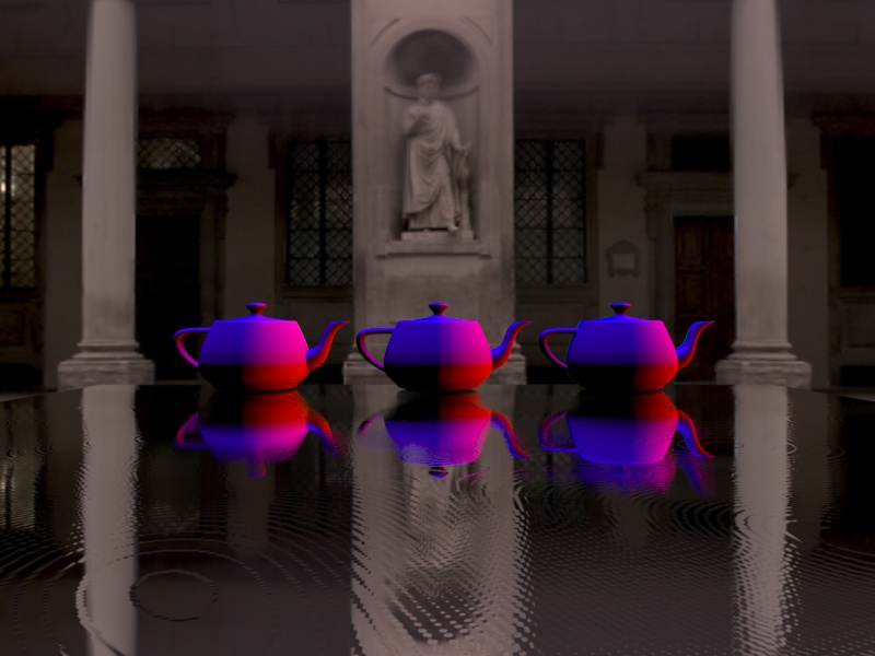

Here are some results with the new code:
There is now a 'smooth' toggle for the texture that if enabled, will do the conversion to 32 bit and smoothing.
This will be available in the next Indigo release.

This is great, thank you!OnoSendai wrote:Here are some results with the new code:
