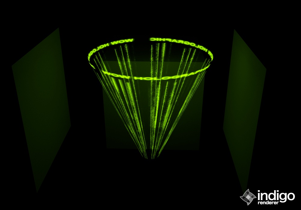

I was making a new test scene with a modified version of the holographic material suvakas made a while back, and I ran into a little problem.
The scene is really simple it's three planes each with a variant of the material now each material is a "light" in itself as it's a blend between null and emissive phong. Now my problem is that it says my scene must contain a light source even though there are three of them present :?
P.S: Before you ask yes environment is set to "None (lit by mesh emitters)"
P.P.S: The name of the blender material also matches the name of the blend material inside the .igm

Anyway here's my test scene.
_HoloDisk.pigs
(253.15 KiB) Downloaded 217 times
dag
Posts: 189
Re: Emissive Blend not a light?
Post by dag » Thu Jul 01, 2010 11:21 am
Use white or uniform base emission. Also invert your blend map.
Post by Borgleader » Thu Jul 01, 2010 12:20 pm
Its working :) Or at least...the scene renders now I must play with it...
