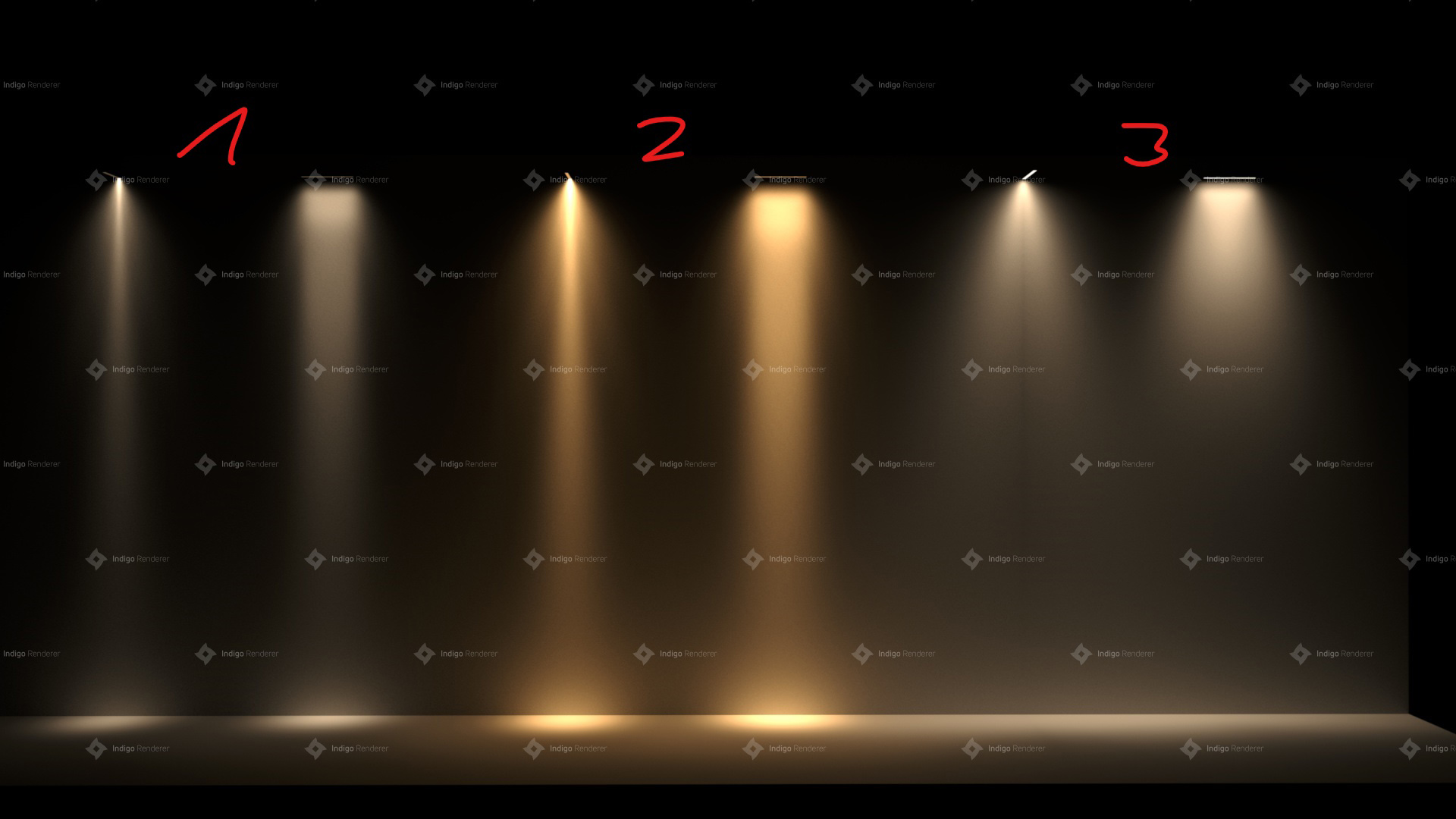

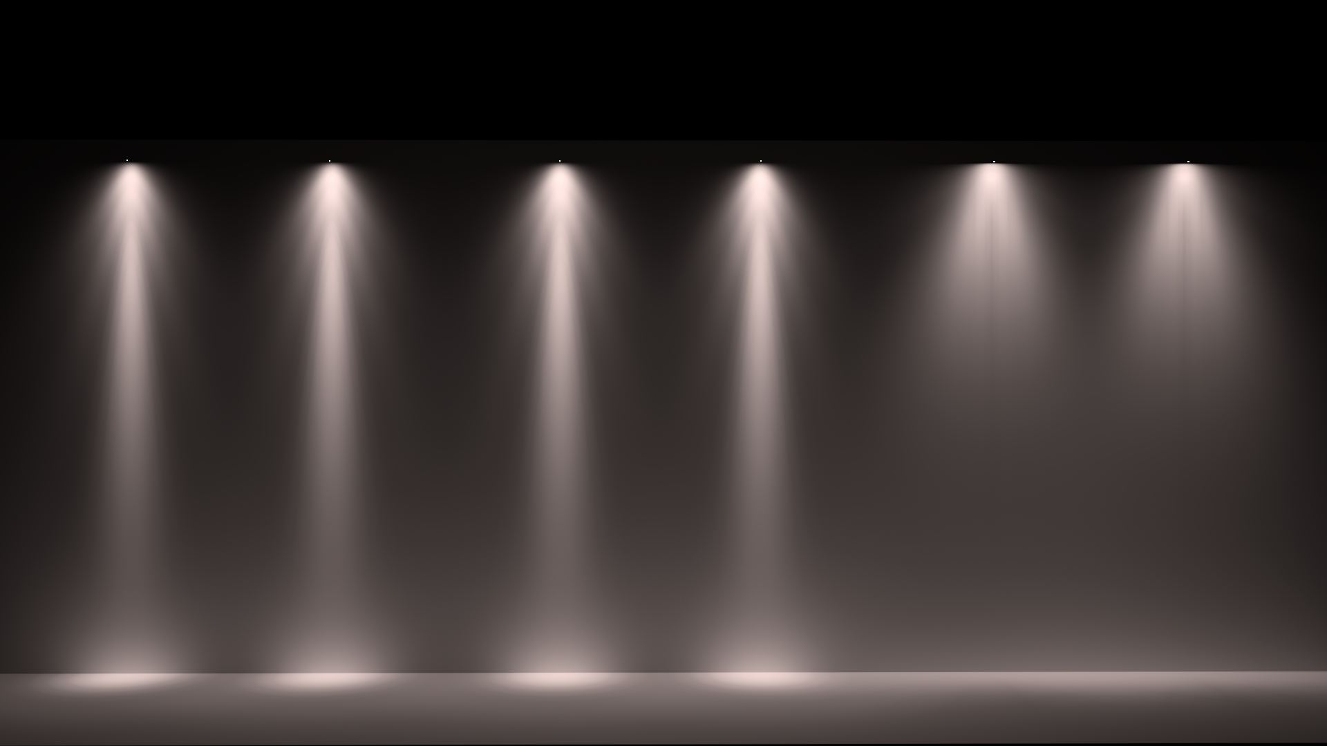

During my tests, I encountered a problem with IES-files. In the renderings, I attached, are 3 different IES-files from iGuzzini (https://www.iguzzini.com/). As you can see, they are all nearly the same width.
But they should have noticeable differences in width.
The two lights on the left (number 1) should be 34cm, the two in the middle (number 2) 64cm and the last two on the right side (number 3) 127cm.
So, what is the problem? Is it a generall problem? Is it possible, the IES-files have problems?
The documentation says, that indigo is capable of "just" rendering IES-files below a vertical angle of 90 degrees (https://www.indigorenderer.com/document ... ies-lights) Could this be a reason?

Hey polygonmode, nice to see you giving Indigo another try after all these years, welcome back!
For IES lights try using only a single 1 triangle emitter, since each triangle of the emitting mesh starts emitting its own IES...
Maybe just share your C4D scene and IES file so I can have a better look into your setup

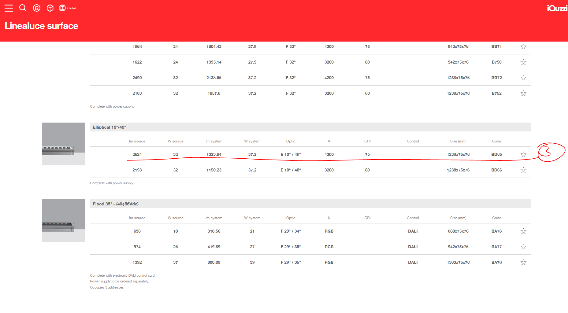

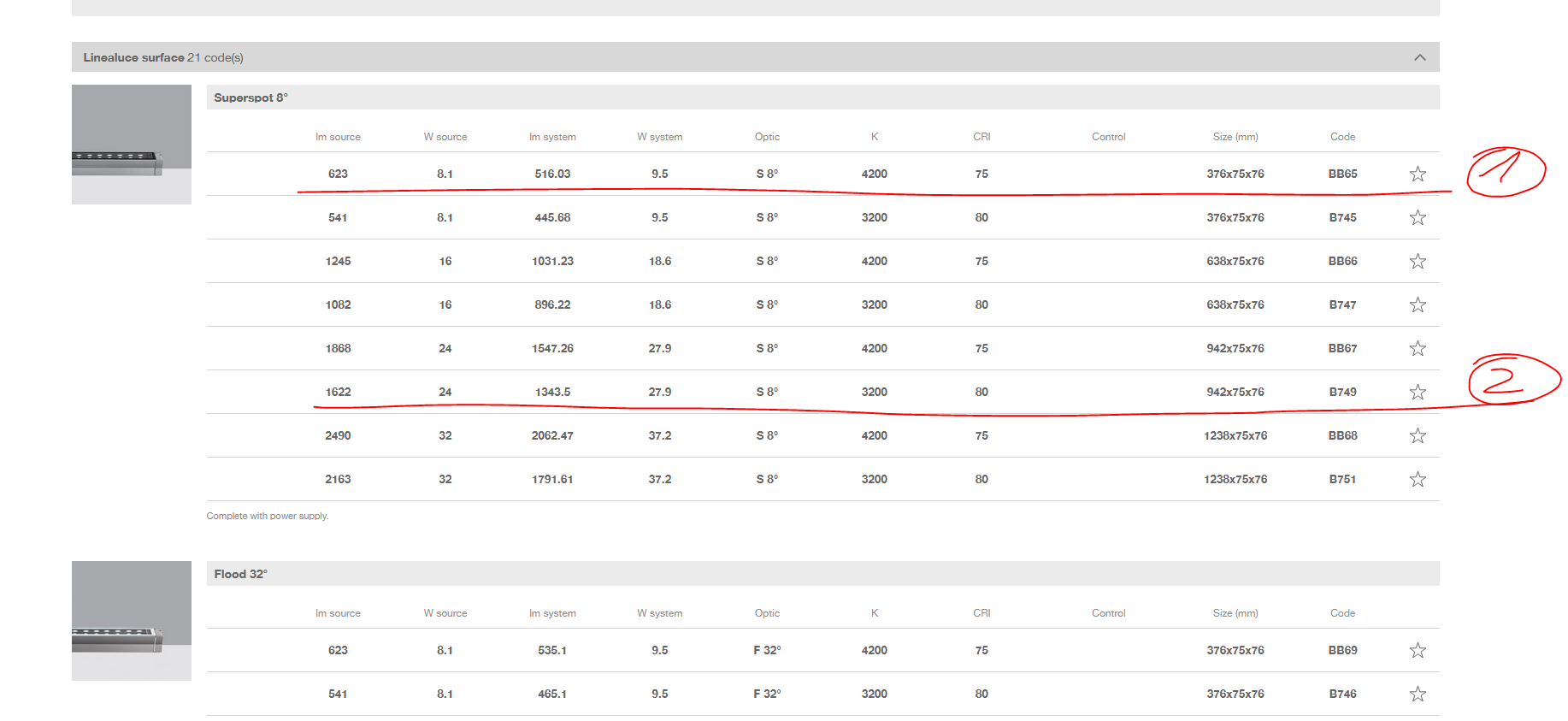

Here is the link to the products and I also attached screenshots where you can see, which type of light I used.

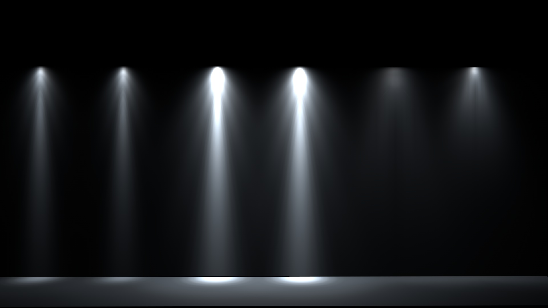

Re: Question about IES lights
Hey polygonmode,
in my understanding of IES it is a purly 2 dimensional information that get extruded like in a Lathe Nurbs.
Therefore there shouldn't be any "other side of the light...
I attached my way to work with IES (and light in general): via material Emitter and a mesh you put it on.
Your way can "stretch" the IES by having multiple polygons (via a plane emitter).
If you have the feeling in a scene a IES does render very noisy compared to other bigger light sources, try to raise the "Emission sampling Factor" (in the Base Emission Setting). It does prioritize this light source further against others and allows it to grab more GPU/CPU cycles for calculation

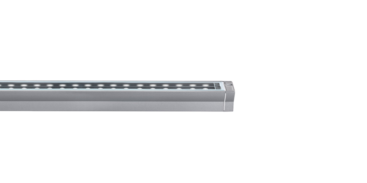

Is it possible to use IES-files which are simulating a rectangular light-source, like an area light?
The lights I have to use look like this:
These lights have a light beam like this:
These lights have different sizes, they vary in length between 61cm and 150cm. You can find them in the attached zip.

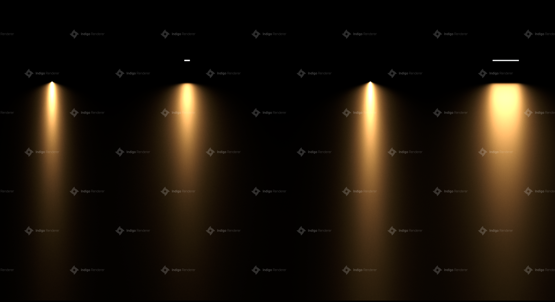

Thanks to Zom-B and his workflow, I made some progress.
I used an emitting null_material, applied to some polygons with the corresponding dimensions (61cmx5cm and 150cmx5cm).
This seems to work. as you can see here:
But I am not really sure if everything is correct in terms of energy, which is emitted.
The problem is, the light-setup has to be correct in terms of light-contribution and not just the look of the lights. That's why I am a bit nervous about how to handle these IES-files.
