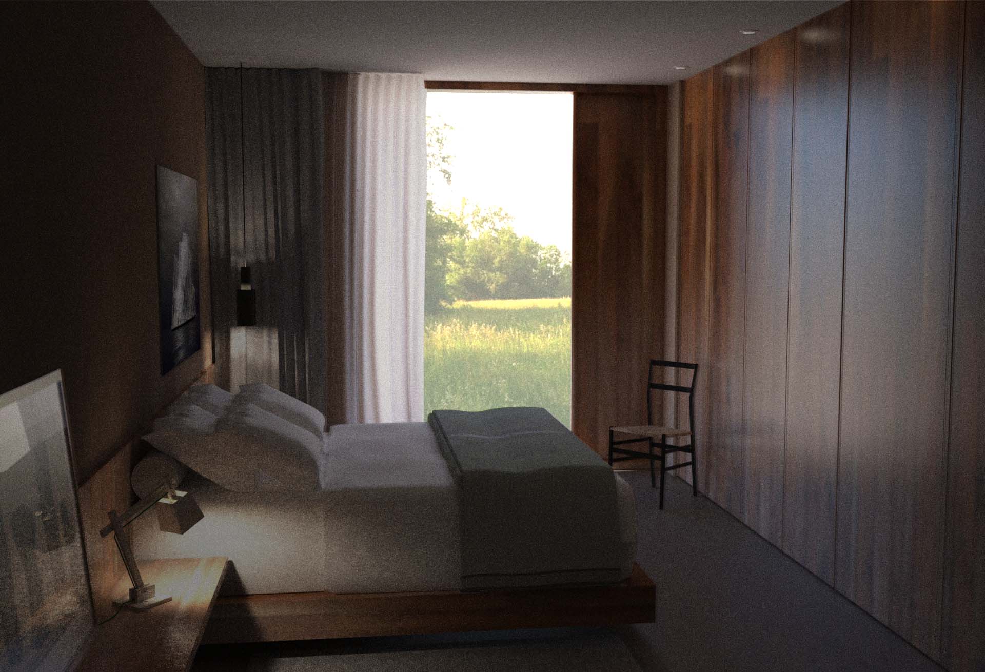

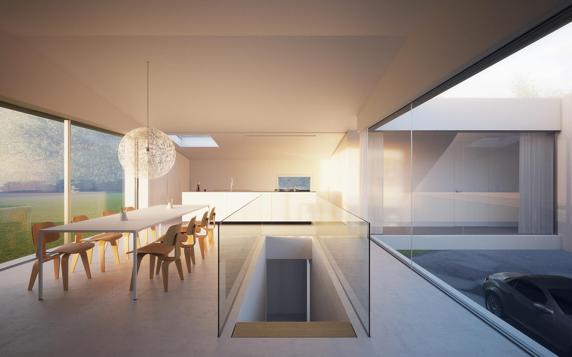

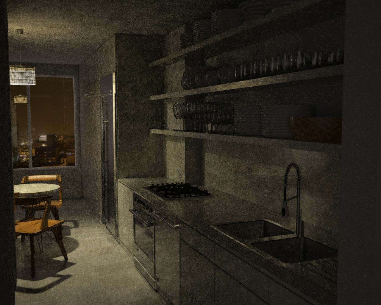

I'm rendering a room. My light source is coming through the window (an exit portal) I think that in the real world, even when the sun comes through a window; that glass window will reflect the interior. But in indigo, when the light comes from outside it will not reflect unless I lower the outside light and put a much brighter source inside.
Here are a couple of examples done with skindigo.
first is a render done with another program by someone else that explains what i'm trying to do when it comes to reflecting furniture even when the light comes from outside
then 3 examples of renders i've done with exit portals and in "sun and sky" mode.

the film is burnt out by the exterior light, there's no room to capture further details. In addition the glazing angle is head front wich minimizes reflections due to the Fresnel scale.first is a render done with another program by someone else

In real life you see reflections in the window glass, because the human eye is an amazingly powerful camera.
If you try to take a shot of the same situation even with the coolest hi-end camera you will loos most of the reflection, even more if there is big contrast in the scene (dark inside, light outside).
That is the reason why in CG they generally tend to put some curtains at the window.
In the case you posted as a reference, there is a strong probability that the outside has been photomanipulated after the rendering, or even merely added (so it is not rendered, but is a background image adde in postpro). Using Indigo you can do the same thing enabling the foreground alpha option: this way, you'll keep all the reflections, but you'll be able to easily add a whatsoever background you need to the final render.
