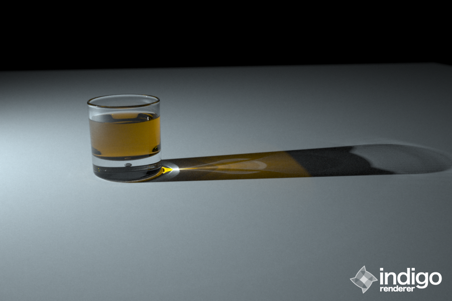

Hi all,
Im new here and new to indigo renderer, hope to find help with my problem.
Im getting hard shadows when render glass bottle I think ive done everything and tried all the ways but still no effect that im looking for, see te image below thats my render in indigo:
http://img194.imageshack.us/img194/382/ ... 1314sa.png
i like the coustics but dont like that hard shadows, ive rendered same scene in maxwell render to compare so u can see difference here:
http://img805.imageshack.us/img805/2050 ... sl1442.png
maxwell has much softer shadows why i can't get them in indigo?
any ideas?
Many thanks.

Re: Hard Shadows through The Glass Bottle....
You just need a larger light source

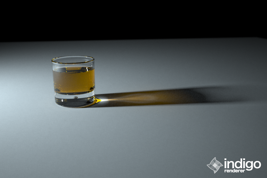

Ono gave you the answer - two quick example renders attached.
edit: just realized, maybe you are misunderstanding "larger" as "brighter" - you need to make your light object physically larger in scale to get the softer shadows. brightness stays the same.
The C4D exporter only does basic transition from C4D Lightsources to Indigo ones. Actually the exporter creates a mesh and puts a emitter material on it!marasek wrote:But I did not mention that Im using C4D and I used point light to light the scene and with point light Ive change cone angle much wider and unfortunately the shadows dont get softer feel at all...
Working in Indigo you should adapt the workflow to create a emitter mesh and put a material on that, its the way to have full control of every aspect of the output
I would suggest you also smooth your mesh further, to prevent (subtle) edges that are "normal-smothed" on the surface, but maybe still relevant for interaction with light (I'm not sure about that at all!?!). Using the SubDiv tag of Indigo with smoothing turned on will do the jobmarasek wrote:I dont know, maybe it dos not work with cinema lights, it works with light objects well, they are much softer but not much transparent, is there any solution for this?

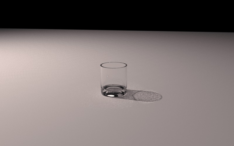

Ive tried one more time your solution and seems to be fine but I get some strange artifacts:
http://img10.imageshack.us/img10/7443/i ... 3340sa.png
Any ideas??
Any form of caustics will require "Bidirectional with MLT" as Render mode. Not sure if it's called the same way in Cindigo (I use Blender) but that's the way its called in the Indigo UI.
The next thing you can try is to increase the supersampling factor from the default 2 to 3 or 4. The artifacts "fireflies" may just be unresolved caustics and will vanish over time.
Changing the cone angle does not change the punctual nature of the light source. The most typical light source in Indigo is a planar surface.
Punctual lights and Single Path Tracing together can often lead to such artifacts. What Headroom says.
