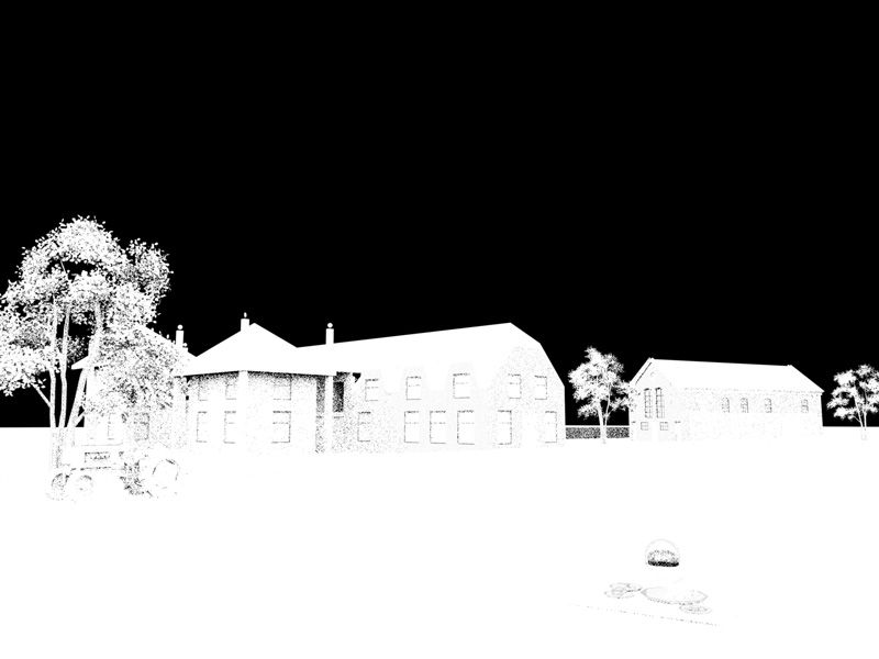

Is there any other way to get good Alpha instead of using Alpha renderer. Current Alpha renderer suck. It computes shadows, and after 1 hour rendering I still don't get acceptable image. Non alpha rendering was acceptable after 6 hours.
I got an idea to replace every material with black diffuse material, and turn background to white and render this image, and finally invert result in Photoshop. This way Indigo rendered acceptable image in 20 minutes. But replacing all materials took 40minutes.
Problem starts, when I decide to change something in scene. It means I have to do this over again and this pisses me off.

Hi Reinuvader, there may be a clay mode that you can activate along with the alpha rendering. Ideally you would be able to specify the material used as clay.

Alpha rendering is still borked at the moment, I believe. It used to work and be quite fast but I think it's on their to-do list.

We are looking into this issue.
For now, using only diffuse/oren nayar(clay mode) in alpha rendering is the only workaround.

CTZn wrote:Hi Reinuvader, there may be a clay mode that you can activate along with the alpha rendering. Ideally you would be able to specify the material used as clay.
I am using Sketchup, and didn't find Clay mode in Skindigo. Is it somewhere hidden? I know in Blender there is switch to turn Clay renderer On/Off. Even better would be if one could replace all materials with custom material.

I'm not a SketchUp user Reinuvadier, hence my use of conditional. If I refer to this post from an earlier SkIndigo version, the mode you are looking for might be called 'monochrome'.
