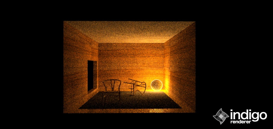

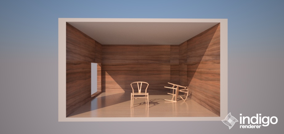

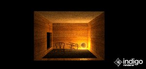

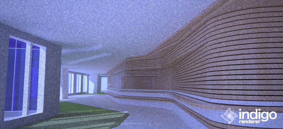

hi i'm new to indigo render, happy so far but for some reason my exterior renders look really nice and sharp but not the interiors, they look pixelated even if i have render both the same amount of time.
anyone can help out on this? would be much apreciate it.
here are examples so you guys can see what i mean. I wish all images would look like t1. Thanks

for interiors make sure to use Exit Portals to speed up rendering a lot (see manual for detailed explenation how to set them up).
Your bluish interring also seems to have glass windows, in this case try MLT+BiDir over pure PT for a better result!
Also something to try out would be the new Glass Acceleration feature (for BiDir mode)

Your orange tinted Image seems to have some strange lightsource, no idea why it is rendering that slow.
double check your light emitter mesh to have normals facing outside and also try to use lower poly meshes as emitter to speed things up

As Zom-B said, you have strange lightsource in night scene. Probably Glossy Transparent or something worse. In this image I would use simple white diffuse material which emits light.
I am not sure what 3D software you use, but if you use Sketchup, then in your first image (bluish interior) it seems to me you have white default material. You should change it as soon as possible, because it looks sometimes like an emitter too. I have made my Sketchup default startup scene to have only one diffuse material which is "white plaster" and I apply this to every object if I don't know what final material should be.
