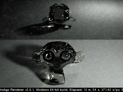

I have recently finished a test using only mesh emitters where glass acceleration dramatically improved the results, you can refer to this link to see the test.ior wrote:I see that developers moved a step towards the possibility off rendering refraction caustic effects by using Glass Accel.

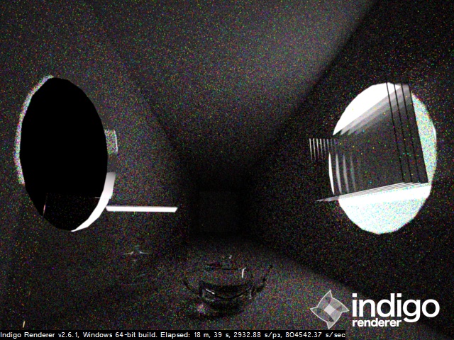

OK here is my reflected caustics test, 30 minutes with a laptop.
I am also making use of glass acceleration. I have yet to run any comparisons with and without as of yet.

Also here is the same test without glass acceleration, this time only 14min though.
