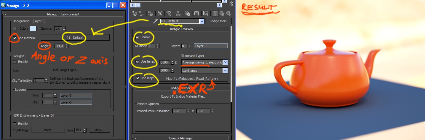

I need info how make fake sun when I use hdri map. I saw great tutorial
( http://www.indigorenderer.com/forum/vie ... =19&t=5088 ) but for cinema4d but in 3ds max is different because in Maxigo plugin doesn`t work rotation, scale and move in hdri map so I cant change position of sun like in Zom-B`s tutorial

in my latest Project I used a quite simple technique to work this out:
Simply open the EnvMap in PS (or whatever) and create a circular overlay over the actual sun and fill it with extreme bright white color (different color to simulate dawn etc.).
Take care don't to use to bright white! in 32bit term I use a white around +10 to +12 Exposures.
The rotation issue should be actually a basic function in the Exporter, but well... you also can turn your whole scene, or simply with the related PS filter (forgot english the name -.-)

Post by suvakas » Wed Aug 25, 2010 12:52 am
You can rotate your env map 360 degrees over Z axis if you use an emitter material as your environment. Other directions are not available though.

suvakas- thanks, yes this is good idea but Ive got map in *.EXR and use as environment not emitter.

Post by suvakas » Fri Aug 27, 2010 1:18 am
You can use your exr inside a light emitting material and then use that material for environment.
Re: fake sun+env in 3ds max/Maxigo ?
Post by suvakas » Fri Aug 27, 2010 5:49 am
@hcpiter
Check out the screenshot I made for you:

Post by hcpiter » Fri Aug 27, 2010 7:00 am
suvakas-awesome! thanks very much for your help :) Now is easier setup sun with env
here quick result with fake strong shadow sun+env hdri map. It`s work :D
cheers :)
