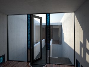

Post by CTZn » Tue Jan 04, 2011 9:44 am

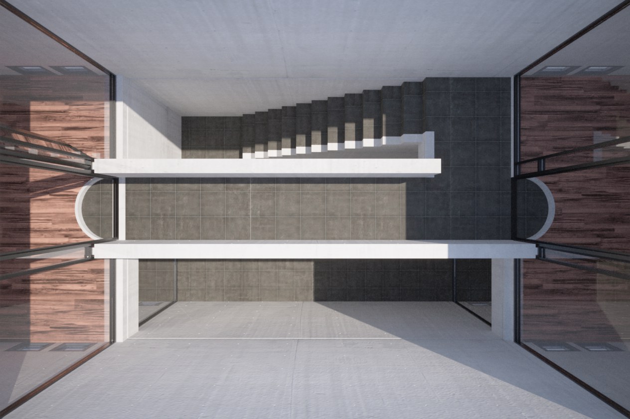

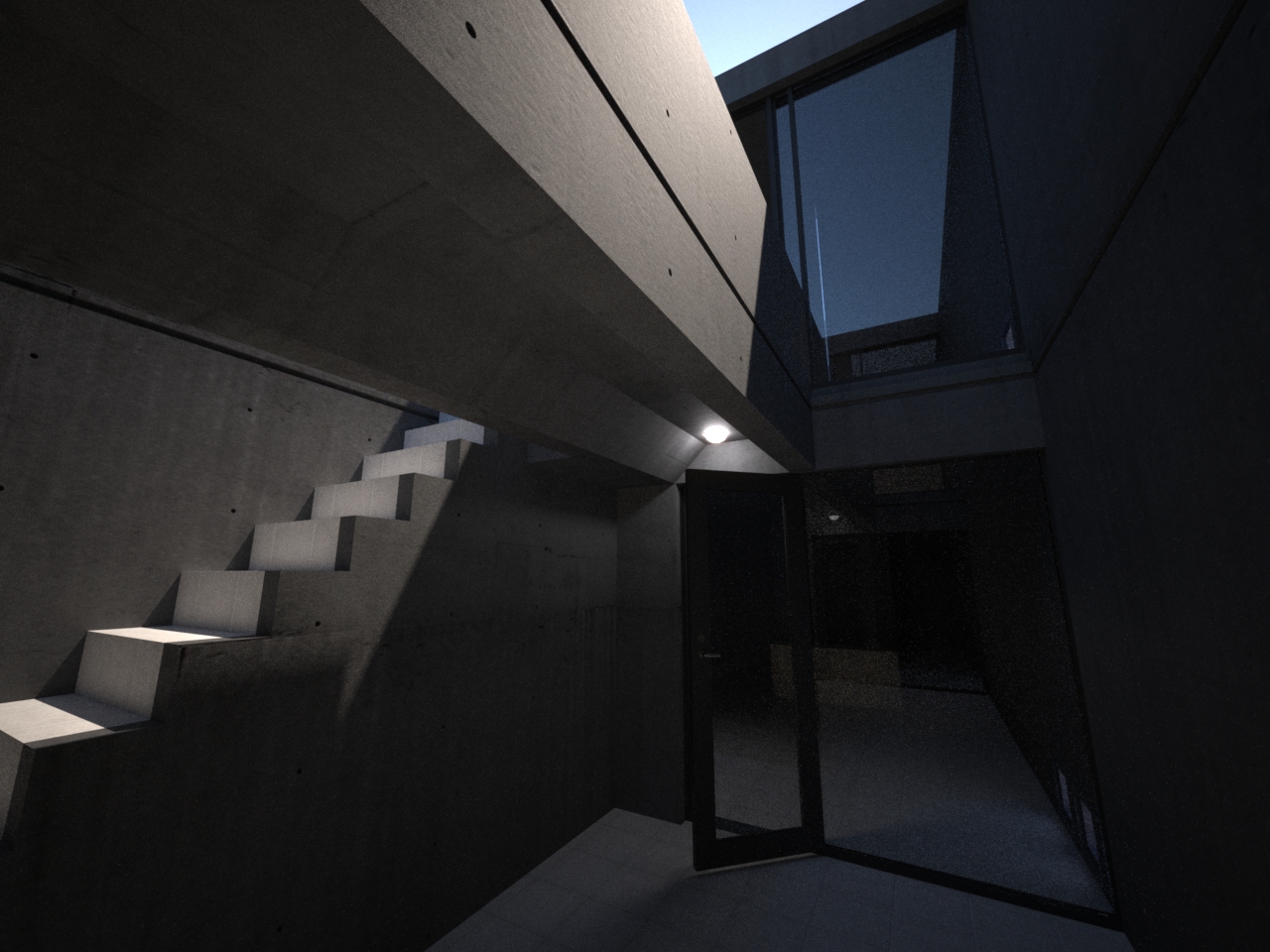

I'm starting a wip based on Ando Azuma Row House, skp file provided by Ronen Bekerman to its newsletter subscribees (form on the right). Exportd to obj from SU8 (just installed), tweaked 2 UVs and plugged bumps, 1h rendering (MLT Bidir GlassAcc).
All openings have glass and portals, the top one only a portal.
Next I'm going micro-poly, and then will grow stuff around and do props eventually.
ps the image is not gamma corrected

I think now is too dark and view is too "sharp" Its good to setup all in grey render. This is good project and I think will be good affter a few changes :)

Post by CTZn » Wed Jan 05, 2011 3:04 am

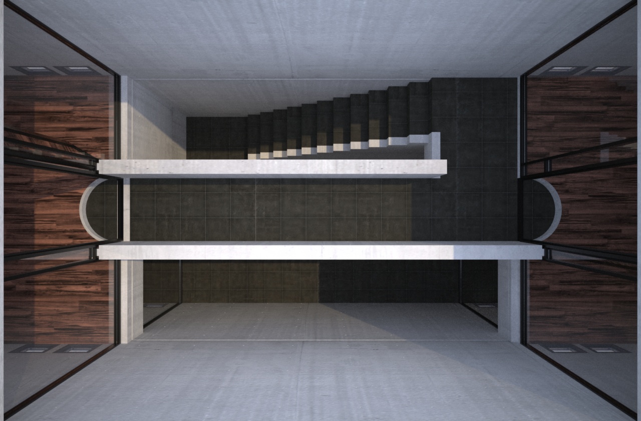

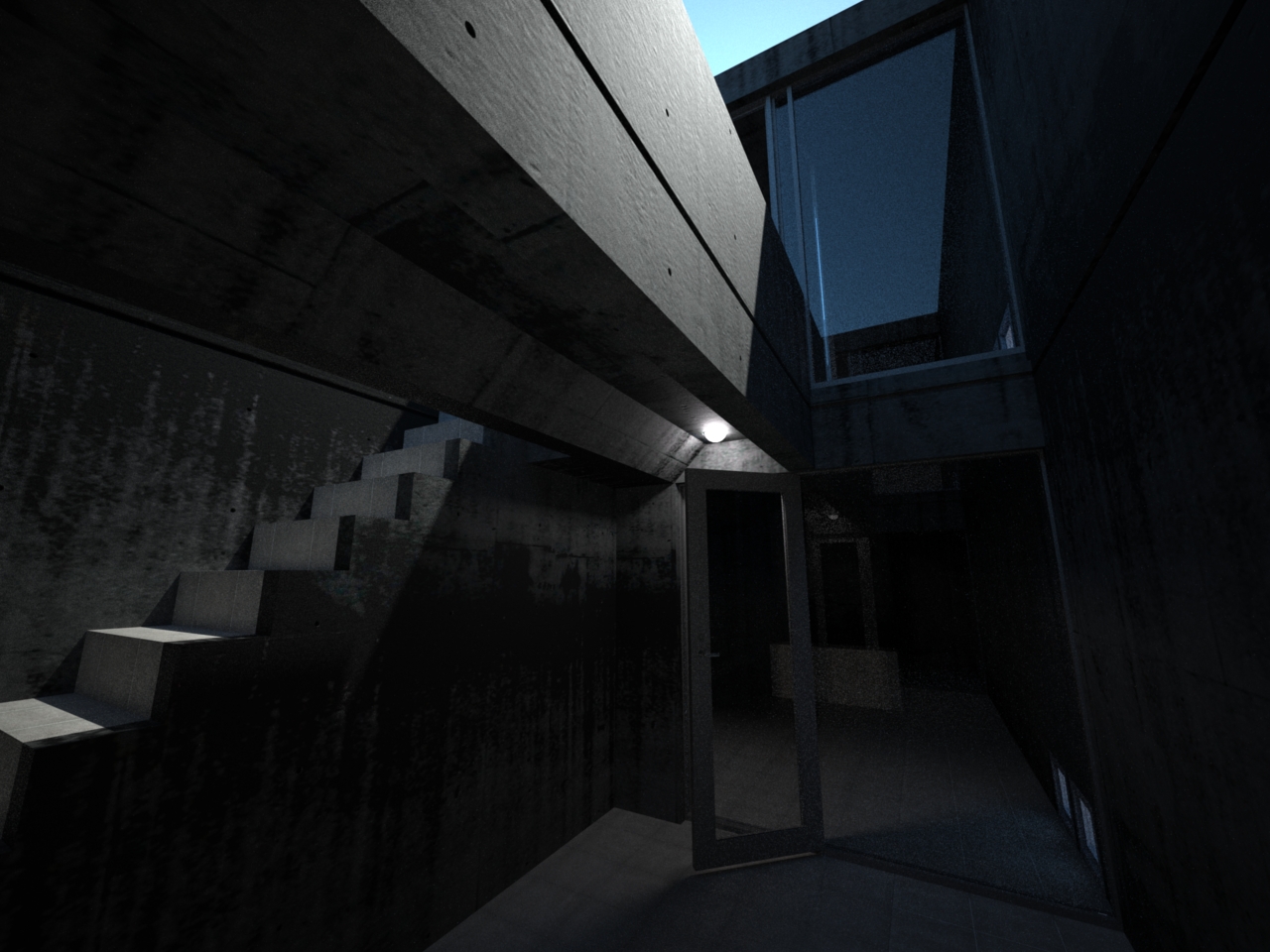

Yes it is dark, textures and colour have a gamma of 1, this was a test. Do you mean setting lights on a 50% gray "clay" render ?
Another render with gamma 2.2, still 1h.
If I want to use displacement on the walls I may have to redo them, I'm not sure I will. But on the other hand I can't live with these straight edges and the triangulated geometry I've got in Maya is a no go with meshes fun.

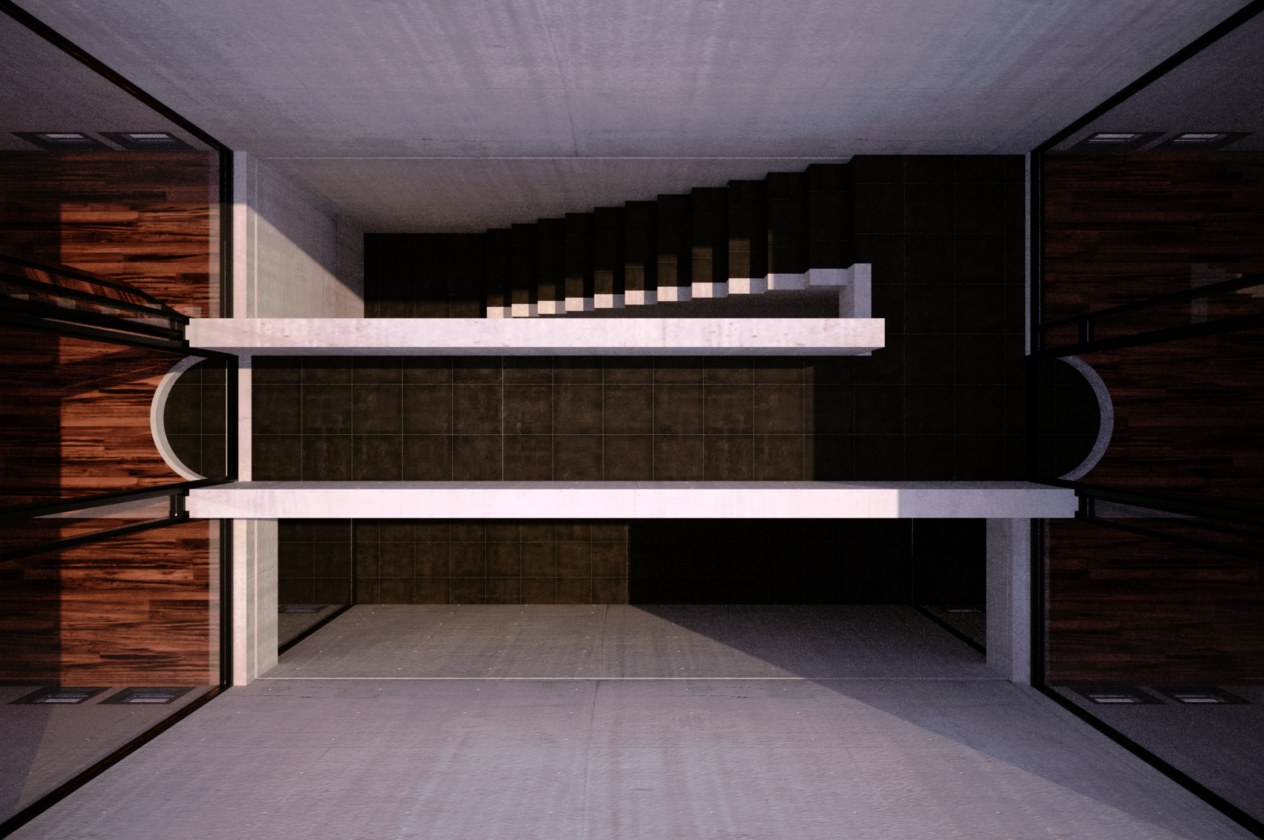

Closer to the expected tones, the second image was me messing with gamma again.
I'm still wandering around the scene, and I'll test various things for having nothing precise in mind atm.

One thing I have problems with Indigo atm is to get such shots lit up correctly.
For such a sun situation the shadow areas are way to dark, and even with paying around
on tonemapping it can't be lit up without getting some overburn on the bright parts...
This isn't the way I expect it to look like :/
Maybe there are camera settings important to tweak this before exporting that I haven't played around with yet...

Post by CTZn » Thu Jan 06, 2011 5:36 pm
There are no customisable curves in Indigo, one must post-prod the render. Raising low levels is always at the cost of contrast, I liked the contrasty look, looks like a photograph in an old magazine :D
If you can figure out how camera responses curves are coded then you can make your owns, with 3 custom curves you should be about set (low, medium and strong boost).
The linked image is linear tonemapping with aggressive curve correction in GIMP. Next I'll give a try at the Picturenaut way.

A raw output for completeness, linear+boosted sky layer, compensated by a lower temperature.

Boosting the "ambient Light" with the sky layer seem to be a quite smart way out ;)
This is maybe also a good starting point to modify some EnvMaps that let you run into this issue too...
Post pro in a external App is always possible, but I was looking into a way to optimize the indigo workflow.

Post by CTZn » Sat Jan 08, 2011 12:51 am

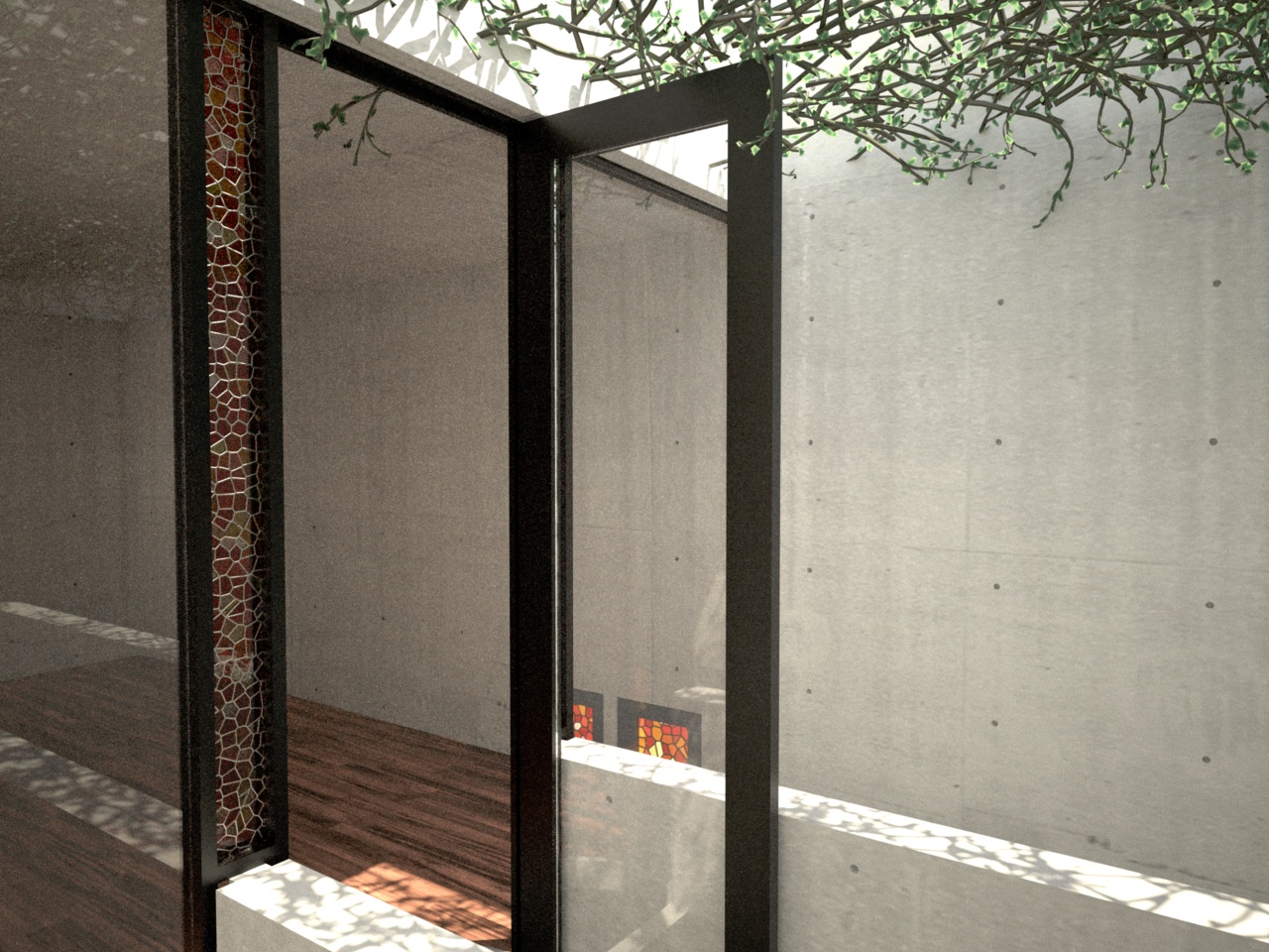

Fooling around. How's the exposure for you ?
no post-pro, Galinette's procedural stained glass.

CTZn wrote:Fooling around. How's the exposure for you ?
Looks spot on. Nice

That stained glass in both shots is nice - how have you dont it?

Post by CTZn » Tue Jan 11, 2011 2:16 am
http://www.indigorenderer.com/materials/materials/688 :)
I replaced the texture with my owns to get custom colors.
Thanks Etienne, it's awesome !
