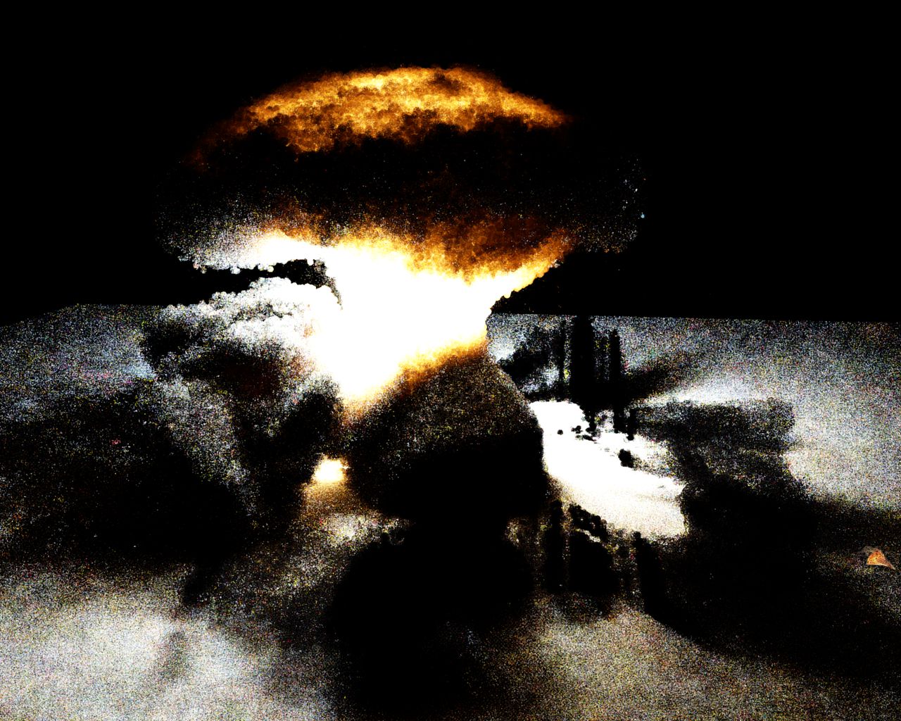

New environmental lighting scheme for your scenes !
(render in progress)

Holy crap, render time?
Re: WIPs: CTZn
About one hour, +23mn now.
Indigo took 1mn40 to initialize and start rendering.
bidir+MLT.
By setting the minimum temperature limit to 450°K, init time should be substantially faster.
I have not exported the full sequence yet (120 frames), but I'll fine-tune densities here and share the scene.
If one knows that the sequence can be rendered with local means, let me know and I'll provide. Not for commercial purposes though
bidir+MLT.

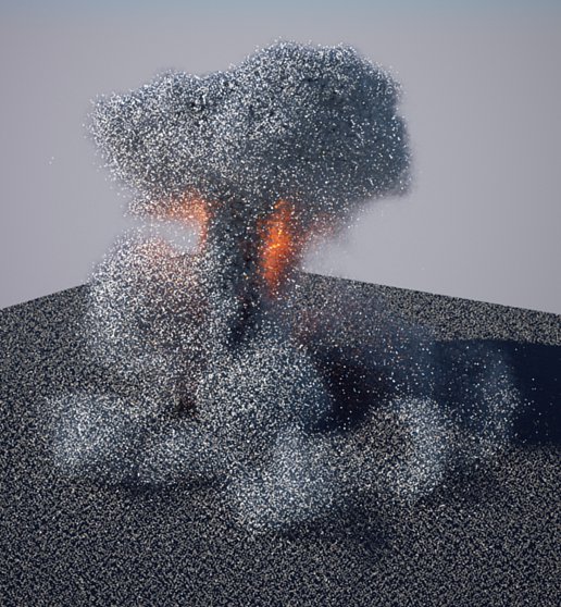

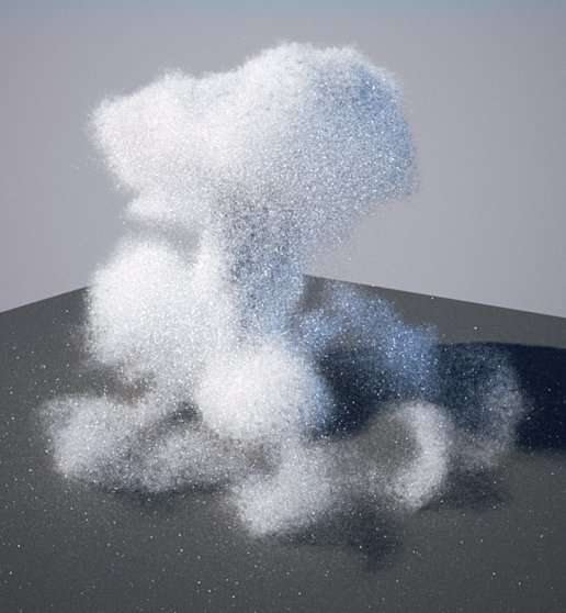

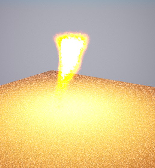

Not as impressive but still illustrative (cropped images). Please note that each of the three components is expressed within the same specular material for one given sphere; there is never more than one sphere by voxel in the global render. I'm sorry about the lighting setup, this is more of a tech demo
I fixed a few bugs, no more rogue dark banding.

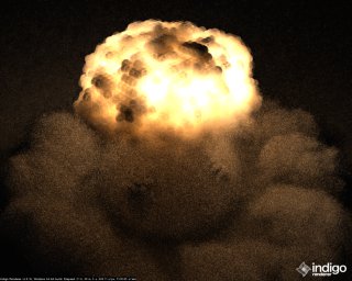

Once again with a quasi-render, equivalent to a supersampling of 4 accounting for the framebuffer, with a little blurring in-between.
I did two things that greatly improved performances for a better trade-off.
First I introduced clamping for the output temperature; hotter spheres will be forced down to a maximum temperature. This avoids small clumps, if not individual spheres emitting outstandingly bright (hot) spots. Rendering such extreme effects becomes comfortable.
Then I left jittering alone, with for effect a muuuch faster initialisation from Indigo due to no intersecting mediums being reported.
(I'm wondering how much just printing such each event for massive sets can be the time hog here, devs ? If it happens once, it just needs a one line output. If it happens more, knowing the event count is what matters, not to have each single one reported.)
The effect is that each sphere is now stuck at the center of its voxel, instead of having it moved randomly within its former space's radius. This comes at a visual cost, but then it's a matter of balance between voxel size, RAM and the final resolution (OT: spotted three-body problem, add time for a fourth dimension !).
I can think of a number of things to enhance the tool, it has been a long time since I enjoyed myself with scripting...
If I ever render a sequence myself, this is the MAXIMUM resolution !
PS: I may drop the mass destruction theme soon, as I can tell it's not your type of humour.

Looking good!CTZn wrote: (I'm wondering how much just printing such each event for massive sets can be the time hog here, devs ? If it happens once, it just needs a one line output. If it happens more, knowing the event count is what matters, not to have each single one reported.)
Printing can be somewhat slow. What exactly is the printed message?
Re: WIPs: CTZn
Exactly:
Warning: Light 'RaySphere' contained in more than one medium, forcing empty/vacuum medium.
About 5 times per sphere estimated can make a huge printing job (exported 2.5 millions spheres yesterday, killed Indigo after hours initializing) !
Thanks !
On a side note, without jittering centers each sphere is still interecting with 6 other spheres (and as many different media), and the message does not appear...
Thanks !

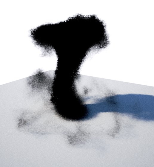

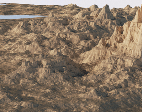

One trick I figured out that I wanted to share (the pic is almost 11 months old already !):
One version of the displaced terrain shader is forcing a black color to the negative side, and you can tell wich in this animated gif. The bright image has got the same albedo in both directions. This is a quick hack for an ambient lighting control.
edit: bottom line: displaced terrains are best "enclosed", ie applying the terrain shader only to the top face of a flattened cube. Don't forget to use some angle based optimization so to have the cube adding 5 faces only to the figure.
