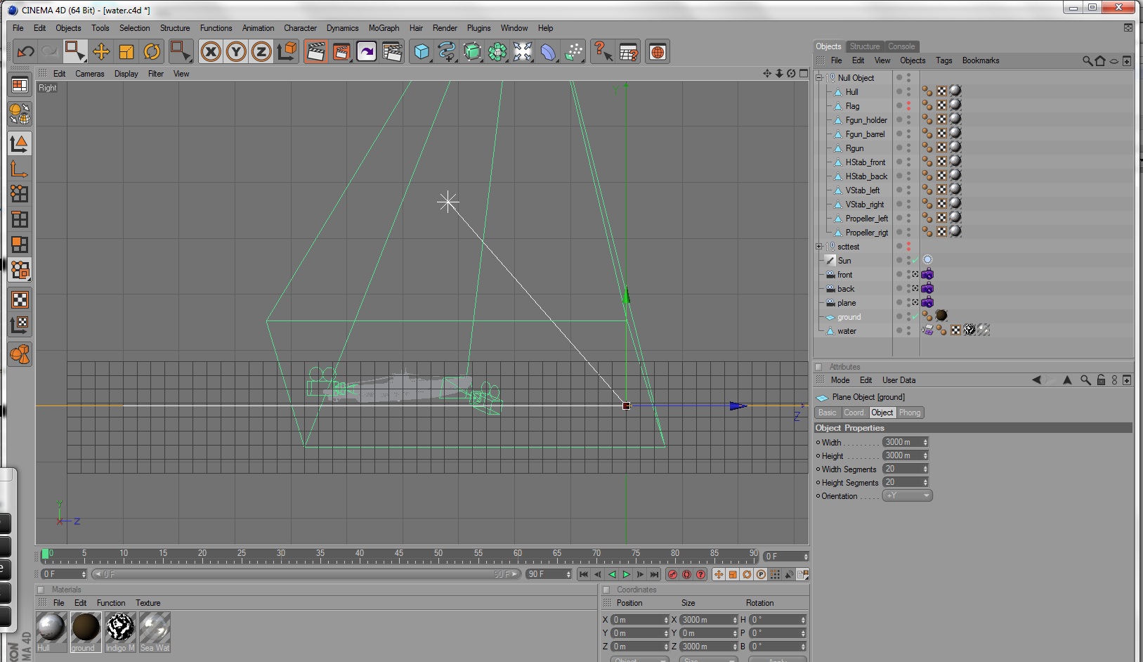

Borgleader wrote:@fused: ok so you used shaders for your waves but apart from that what does the rest of your scene & materials look like? I mean...how did you get the water to not be crystal clear and how did you light it all?
Absorption and scattering :)
Lighting is sunsky only! Its a very, very simple scene.
I would upload the material, but there currently is a bug in the material editor that screws up the absorption :?
Anyway: heres the full ocean water material:
    <medium>
        <name>MedSea Water_mid3</name>
        <precedence>10</precedence>
        <basic>
            <ior>1.330000</ior>
            <cauchy_b_coeff>0.000000</cauchy_b_coeff>
            <absorption_coefficient_spectrum>
                <rgb>
                    <rgb>0.004980 0.003765 0.005882</rgb>
                    <gamma>1.000000</gamma>
                </rgb>
            </absorption_coefficient_spectrum>
            <subsurface_scattering>
                <scattering_coefficient_spectrum>
                    <uniform>
                        <value>0.004000</value>
                    </uniform>
                </scattering_coefficient_spectrum>
                <phase_function>
                    <uniform />
                </phase_function>
            </subsurface_scattering>
        </basic>
    </medium>
    <material>
        <name>Sea Water_mid3</name>
        <specular>
            <internal_medium_name>MedSea Water_mid3</internal_medium_name>
            <transparent>true</transparent>
            <displacement>
                <shader>
                    <shader>
                        <![CDATA[def Vec3ToReal(vec3 v) real : ((doti(v) + dotj(v) + dotk(v)) / 3.0)
					   def noise01(vec3 v) real : ((noise(v) + 1.0) * 0.5)
					   def noise01(vec2 v) real : ((noise(v) + 1.0) * 0.5)
					   def noise01(real r) real : ((noise(r) + 1.0) * 0.5)
					   def fbm01(vec3 v, int oc) real : ((fbm(v,oc) + 1.0) * 0.5)
					   def fbm01(vec2 v, int oc) real : ((fbm(v,oc) + 1.0) * 0.5)
					   def fbm01(real r, int oc) real : ((fbm(r,oc) + 1.0) * 0.5)
					   def mulCompVec2(vec2 a, vec2 b) vec2 : vec2(doti(a) * doti(b), dotj(a) * dotj(b))
					   def mulCompVec3(vec3 a, vec3 b) vec3 : vec3(doti(a) * doti(b), dotj(a) * dotj(b), dotk(a) * dotk(b))
def eval() real: ((fbm(mulCompVec2(getTexCoords(0) * 10.0, vec2(1.00000, 1.00000)),8) * 10.00000) + (fbm(mulCompVec2(getTexCoords(0) * 10.0, vec2(4.00000, 4.00000)),8) * 1.00000)) * 1.00000]]>
</shader>
                </shader>
            </displacement>
        </specular>
    </material>
and a screenshot of the scene:
the white line is actually the ground. I didnt do that on purpose, didnt really realize its just 2m under the sub until Joel pointed that out to me XD

Gorgeous. If I understand correctly you are using only one sub-routine among the 8 declared !?
Thanks for exposing the code fused. I realisd that the first difficulty with ISL was to get the idiom's basics clear in mind :!:
Post by fused » Fri Dec 18, 2009 12:20 am
CTZn wrote:Gorgeous. If I understand correctly you are using only one sub-routine among the 8 declared !?
Yes, these functions are always generated by cindigo if you use a shader node. i have them all there because its just easier ^^
CTZn wrote:Thanks for exposing the code fused. I realisd that the first difficulty with ISL was to get the idiom's basics clear in mind :!:
no worries, Adam!

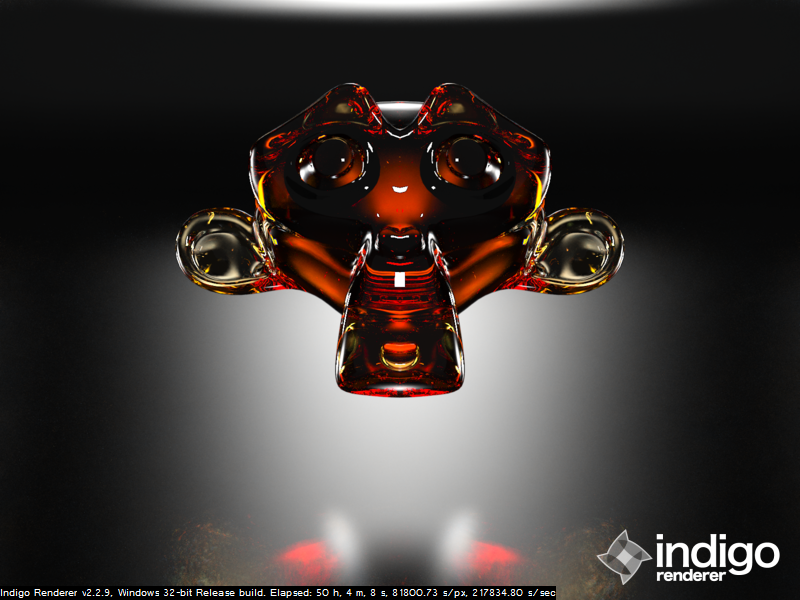

Additionally, here's an epic render that I've just become bored of watching. 50hrs and 81k S/px and still no decent reflection in the floor.
Patience, another quality of yours...
I guess glossy as such is rendering the light paths complexes. Did you nap the render with MLT Doug ? I think that should be mentionary when using transparent specular. Borrow the later but: medium.
Although there is no apparent scattering effect, is there ?

CTZn wrote:I guess glossy as such is rendering the light paths complexes. Did you nap the render with MLT Doug ? I think that should be mentionary when using transparent specular. Borrow the later but: medium.
I think this was with BiDir/MLT with a specular transparent, no sss or dispersion.
the lighting setup is what might be called 'mildly difficult' being a small cube emitter one on each side and a larger, dimmer emitter above and behind the camera. The floor and backdrop are a curved 'half-pipe' type thing with a phong/specular reflective material with low exponent.
All in all some very tricky light paths, and I'm sure they'd converge with more rendering, but as I said.... bored now ;)
