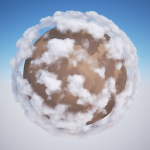

more like this. As it came out the maths were correct but the effect was just bad.
Not sure what the banding is, but I can make it worse...

Stepping artifacts are probably due to step_size being too large btw.

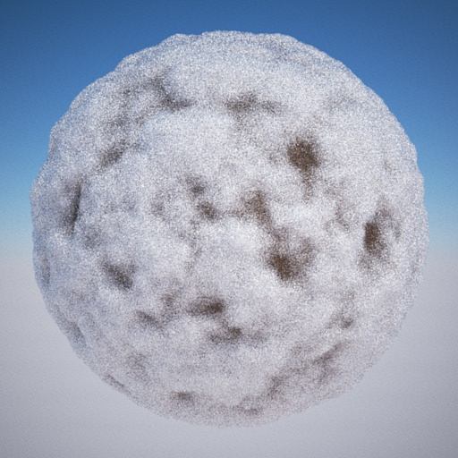

yep they were. Maybe it's too small now... A short serie from the shader featuring a couple parameters. Sorry all are 25 spp only.
power 2.0

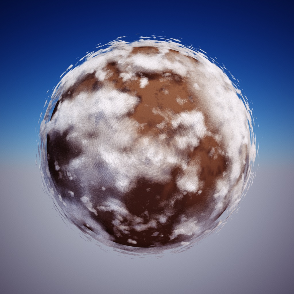

power 1.0
offset 0.0
reference

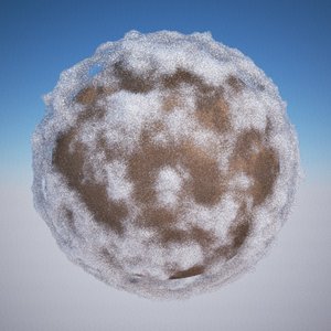

power 0.5

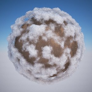

power 0.5
offset -0.125

Maya is optional, the shader is scalable. New version, before only the top part of the clouds was shaped, here both top and bottom have a shaping of 50%, leading to "round clouds" sort of. Plain default, average shader values, no tweaking.
I am going to render someting bigger and with more spp's ;)
new reference

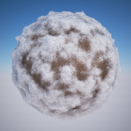

Also the scattering value of 50.0 might be too much, lower value may suffice and converge faster. Inversely, increasing the absorbtion factor will kill more rays and make faster, darker clouds.
Here's what I've got at 34 spp; power 2.0, offset -0.125, shape shift 0.25. What shape shift does is larger clouds, toward their base or toward their summit for low and high values respectively. 0.5 is for the so called round clouds.
boosted the sky layer x2 to reduce apparent noise from sun.
