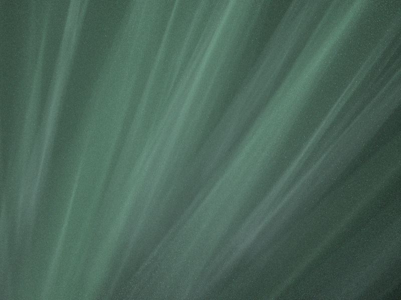

And now, I know, what the problem was: the lower part of the water didn't hit the ground -> partly reflective, partly transparent, strange reflections at the floor
Post by Kram1032 » Tue Apr 10, 2007 8:47 am
I finally got some nice visible lightrays, but nothing else xD
It's still the same scene, but I changed the wall a bit:
It's a blend out of THREE materials:
50% Diffuse pure white
25% Phong H2O.nk with maximum possible exponent inside Blendigo
25% Specular, IOR 1.33, SSS uni1, cbc 0.003, absorbtion 0.
For some reason, this mix turns out black.
Therefore, it makes the lightrays fewable, so that you can see the SSS and the blueish tint.
It's a bit tooooo green SSS, should be much whiter and it renders quite slow: ~93 microsecs per sample
I'll post both the scene (.blend) and the pic ;)
Post by Kram1032 » Tue Apr 10, 2007 9:19 am
here they are!
The pic after 1h
under the sea2.zip
the blend
(1.35 MiB) Downloaded 249 times

Post by Kram1032 » Tue Apr 10, 2007 8:44 pm
Yes! Finally! How did you get those clear rays + anything else!?
Post by Kram1032 » Tue Apr 10, 2007 9:19 pm
Here my final result.
Still noisy, but I wont go on...
more than 13h and not much more than 100 spp ...
volumetric rays with !two! directions, dunno why.
