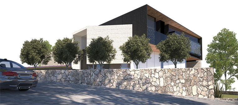

Hi there guys !
I have a question :) ....
What is the right or the best ray tracing method to get rid of the white dots in the black glass ?
The options that Skindigo gives are :
Path Tracing
Bidirectional Path Tracing
Path Tracing with MLT
Bidirectional with MLT
Thx in advance :wink:
thesquirell
Posts: 428
Location: Novi Sad, Serbia
Re: A simple house in Mexico
Post by thesquirell » Thu Nov 05, 2015 3:41 am
That's not a simple house, it's a beauty! :D
For starters, you could make sure you're using AGS(architectural glass solution), or specular material with arch glass option on. The best method so far, for those tricky scenes, for me, was BiDirMLT, but since this is an outdoor scene, I think you might as well go with BiDir PathTracing.
Lal-O
Posts: 348
Location: México
Post by Lal-O » Thu Nov 05, 2015 3:48 am
thesquirell wrote:That's not a simple house, it's a beauty! :D
Hi Squirell !
Thx for you reply and for the kind words :D . Let's wait to see the final result.
Ok......For sure i forgot to set AGS ... i will re-render with the ags check on and see how it goes :)
Regards
