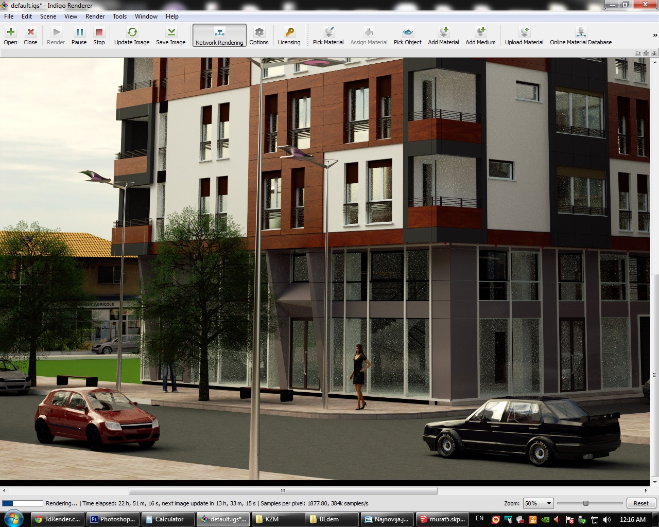

Work in progress.. I have problem with lights, it takes longer to render.. This foto renders for 20h, and it's not clear.. I use glass acelerator, and cuda whit my grafic card.. I need sugestions how to seth scene control, and lights, i have put lights Emision scale 5 000 000 l/m2, and 6000 tempeture, blackbody, s1.. And how to set scene in setup, enviroment ( should i set "add sun" ) ??? MSCR 3000 ??? SUPERSAMPLE FACTOR 3 (should i change that to speed up render)... Any other sugestions are welcome..

It seems you use very small emitter inside your building!
Pure PT has some very hard time finding them, even with GPU support and Glass Acel. on!
I see a few options to help you here:
1) exchange the light inside the house to BIG planes with less emittance!
2) Give (PT)BiDir a try
3) Use region rendering to focus your new rendering on the problem areas only, and merge in PS or gimp later!

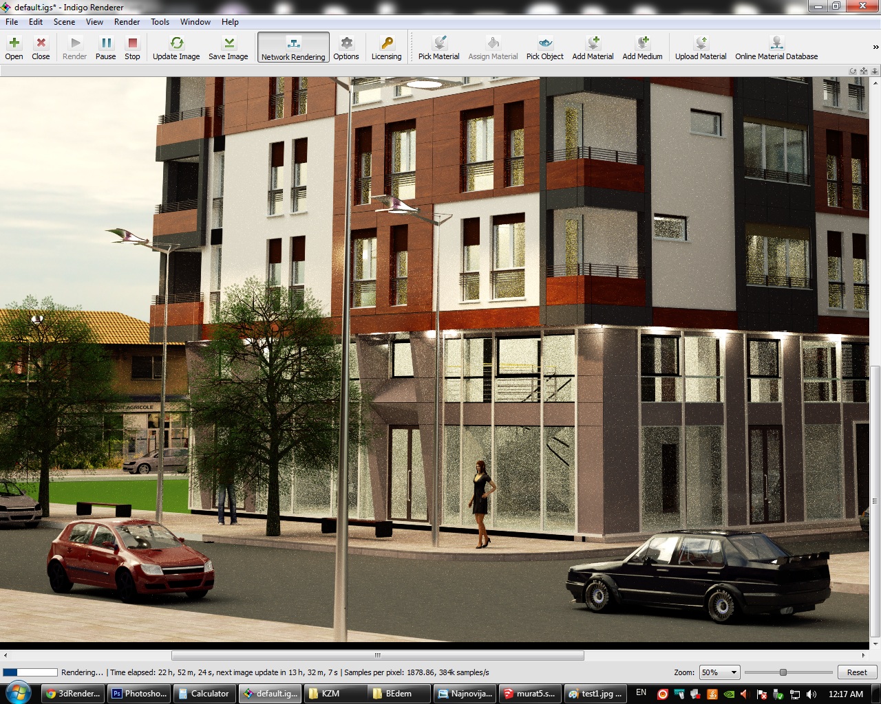

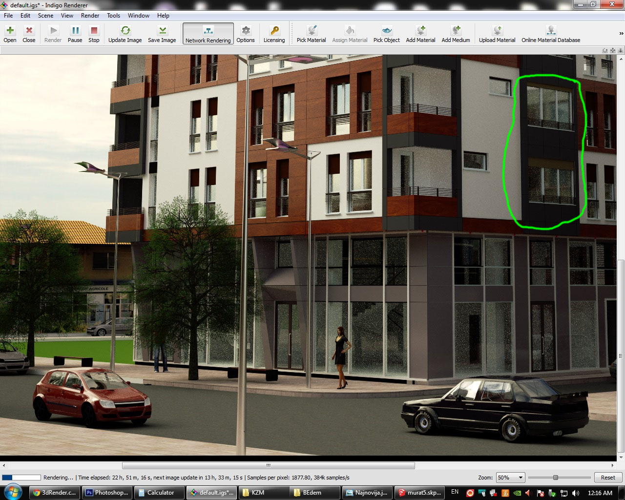

I use path tracing, becouse CUDA aceleration.. This is the diference whit and whitouth lights, i use network rendering, but it doesn't show it remains 380k/s, but on my network render info, it say that just from another pc indigo gets aceleratet 380k/s

Your glass has some quite blurry reflections... why is that so?!
Use a simple specular material with IOR of 1.52 (facade glass may have different IORs but anyway) and set the color to uniform with a value of 0. Don't use glossy transparent material with high exponent!!
Also take care that your wall material for the inner house has not to high RGB values (max of 204) since otherwise the light gets bounced until forever and causes slowdowns + noise (and is unrealistic, since full 255 RGB is a full reflector!!)

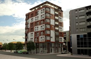

Post by Zom-B » Mon Jun 10, 2013 9:22 am
seems like the lady is still gigantic, same as the guy hiding behind the tree :)
What I just noticed i that your wood textures for the facade are scaled way to big!
I also have to admit that the very strong contrast tonemapping is too much for my taste...
The first floor still looks very noisy :/

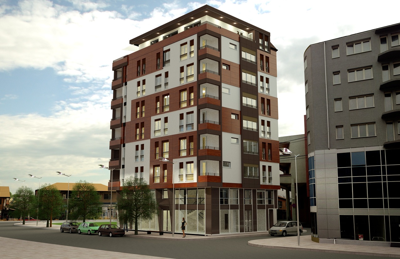

Thank to u all, it really helps :) Here is finale render.

Post by Oscar J » Thu Jun 27, 2013 6:19 pm
Pretty nice!

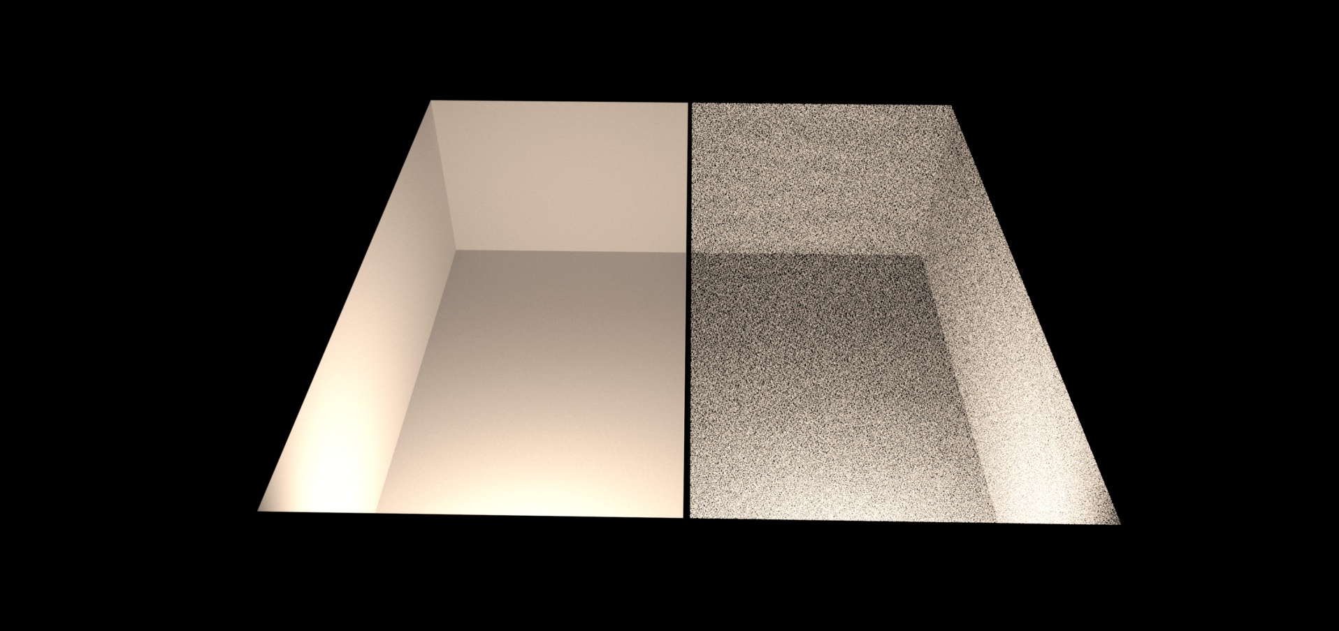

Just in support of this, here is a quick illustration/experiment of the point about emitter power and processing time:
Light 1 on the left has a lumen (lm) value of 500,000
Light 2 on the right has a lm value of 2500 so only half a % of light 1.
The render is left to run for a minute or so and then then the gain of light 1 is dropped to 0.005 (ie half % of the original 500,000) essentially resulting in the same lm value as Light 2. Its pretty clear which light has been given the rendering priority in Indigo.
