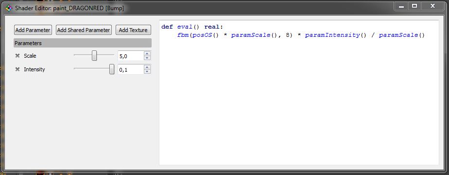

Hi, I wondered how I implement a simple 3d noise shader without UV coordinates plus parameter sliders for scale? Which works in the bump or normal channel?

Use posOS() in place of tex() for 3D placement. pos can be used if the definition has that vec3 declared (NOT bump for instance).
So,
1. create a new (float) param Name
2. add a noise (bump example below):
In ISL, a slider is identified by appending the prefix param and the suffix () to its name.
So,
fbm(posOS() * paramName(), 8) * 0.01

A good practice for bump shaders is to divide the bump depth by the frequency (Name here) in order to maintain the same proportional height relatively to details frequencies.
When present in the definition signature - def eval(vec3 pos) real: - pos will provide the world space position of the point being sampled. PosOS() in turn will use the object space, so shaders will orient with the objects.

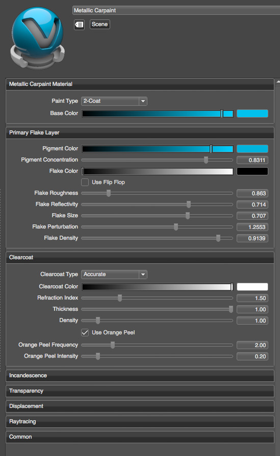

... and this is the carpaint material from Autodesk VRED:
Indigo can do that better!!!
Very easy to setup and nice flakes. Voroni-based.Indigo can do that better!!!

The car paint I made ( http://www.indigorenderer.com/materials/materials/1322 ) uses randomly oriented facets in a grid pattern, I guess voronoi would be better.
