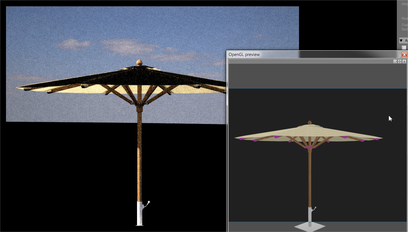

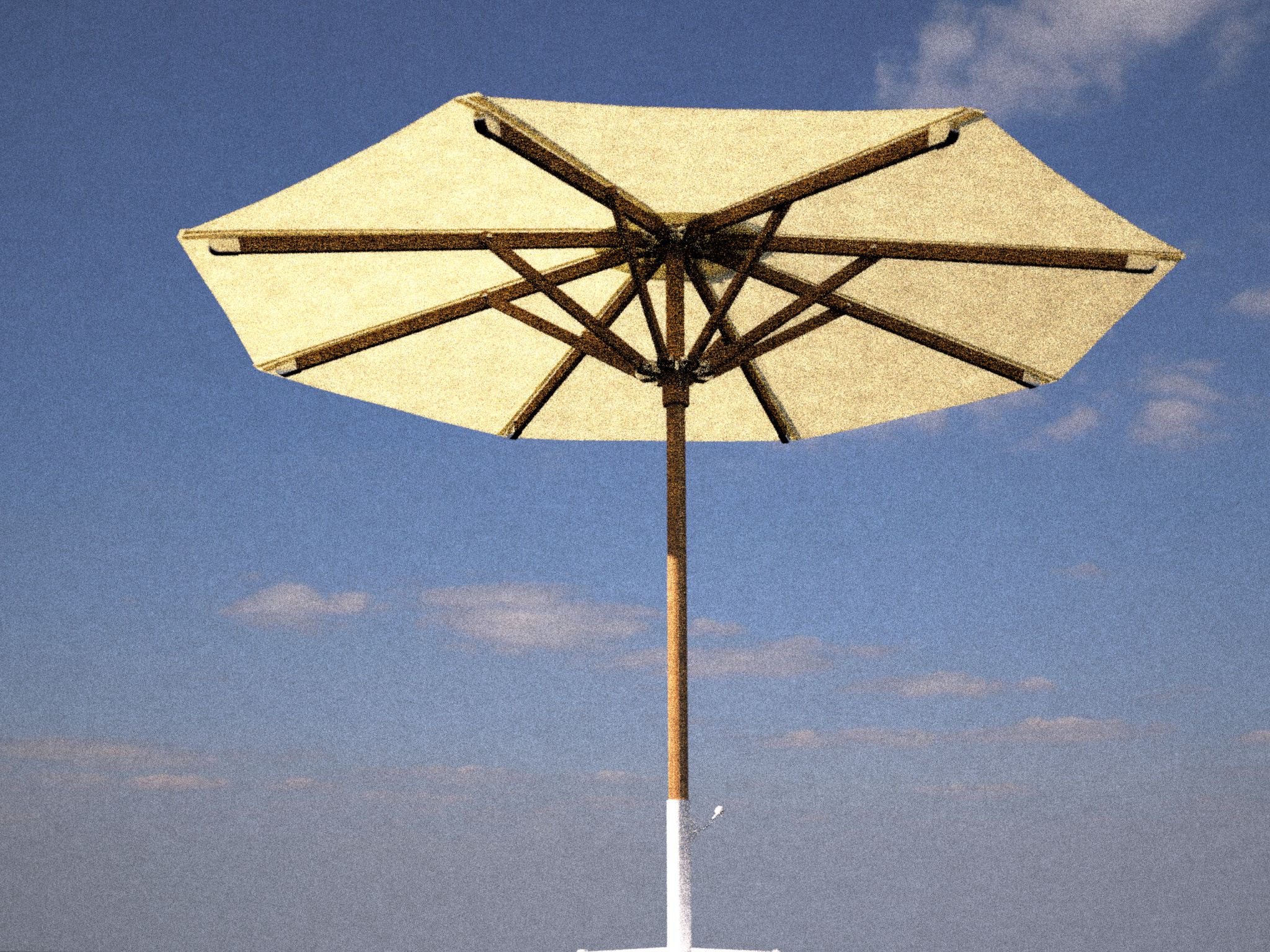

okay, I exploring a quite same subject and I hope to have some clues to know what's happens.
I do not understand why a volumetric mesh do not work in all the sides. (see the picture with the openGL preview).
My scene is simply lighted by a HDRI (+7 in the sun disk)
The material assign to the fabrics of the umbrella is a simple DT.
My test-images linked with that post present misterious shadows/black surface "onto" the umbrella with a volumetric meshes.
But I obtain the same result with a single-faced object and I double checker the normal.
Notice that particular zone in the image do not really change color when I play with the tone mapping.

Re: Transparent materiality
Hello, I answer my self for give some clues to an other users with the same kinf of problem:
I do a misunderstanding between, double sided thin materail an diffuse transmitter.
The correct material that I need to use to do that is the Double sided thin material.
be carefull to the exponent when you use an phong, because it multiplied itself with the parameters into the "double sided thin"
