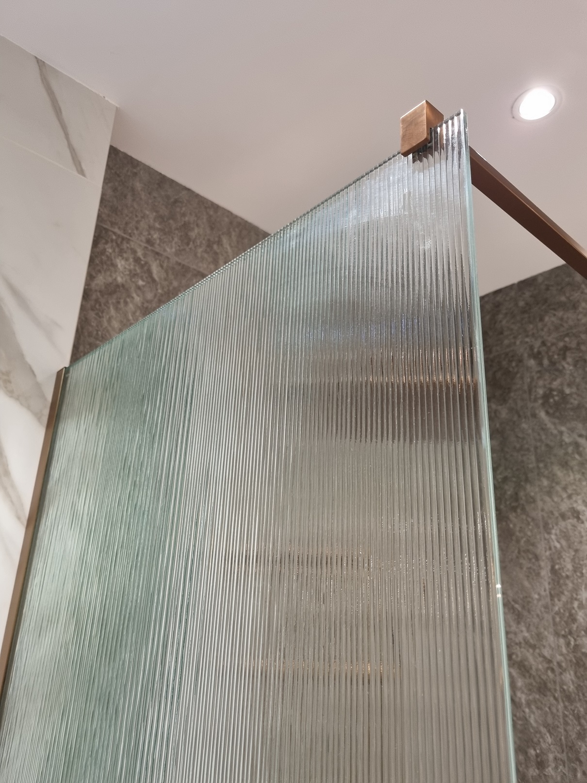

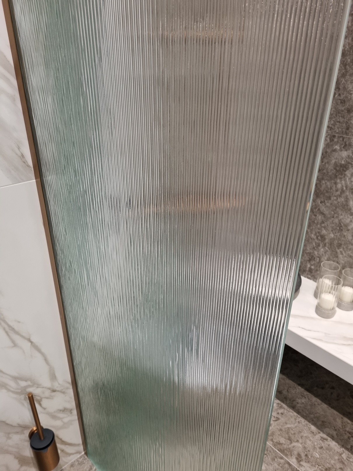

I'm a hobbyist with this render, I use it in conjunction with SketchUp 2017
As in the subject, please provide instructions on how to make such glass.
Colorless, not completely transparent.
Smooth on one side, visible groove on the other (photos attached)
I really want this similar glass.
Best regards

That sir.. that's how its done! Great work

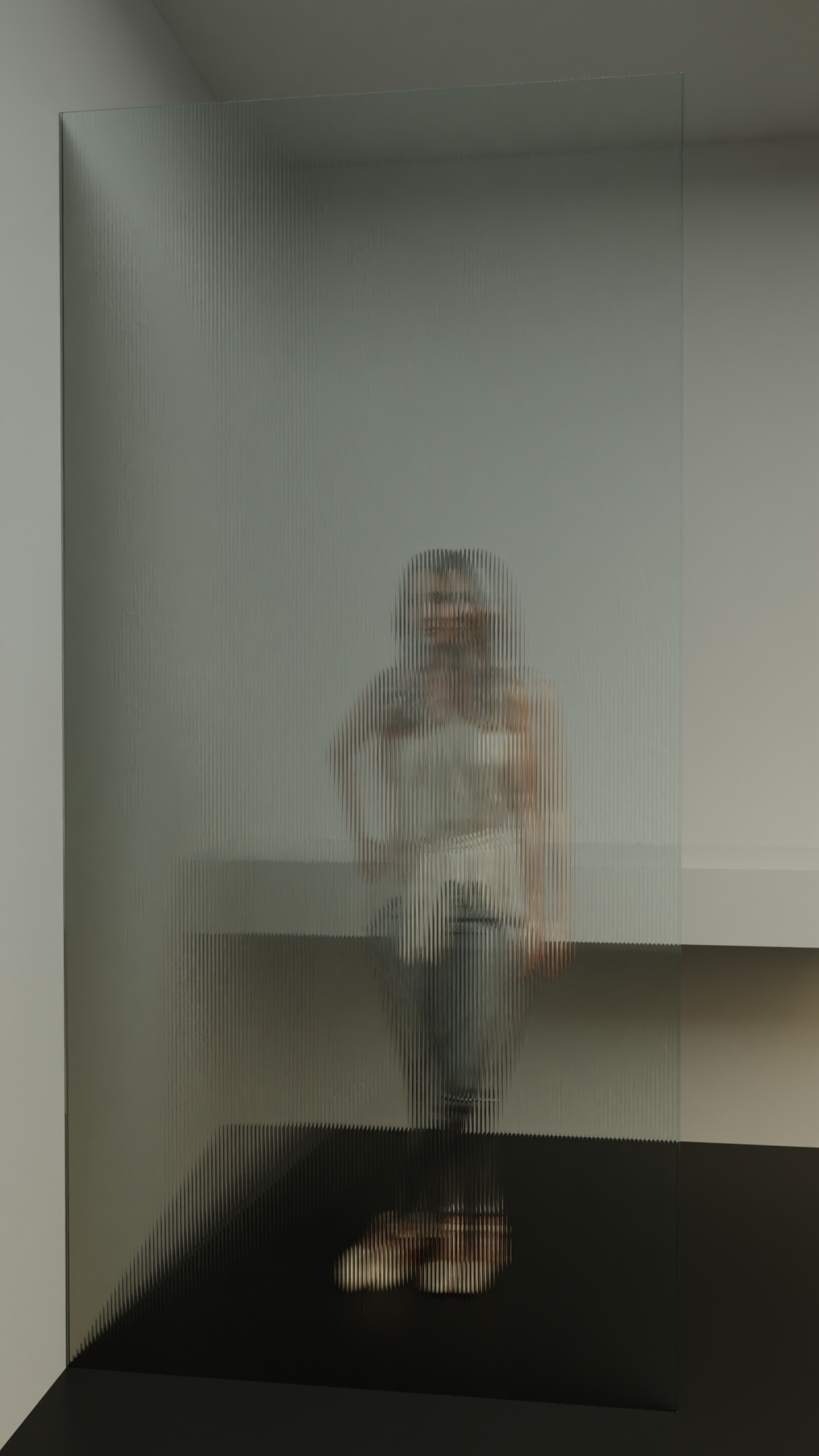

bidir test
vs
path tracing on gpu diffuse depth 12

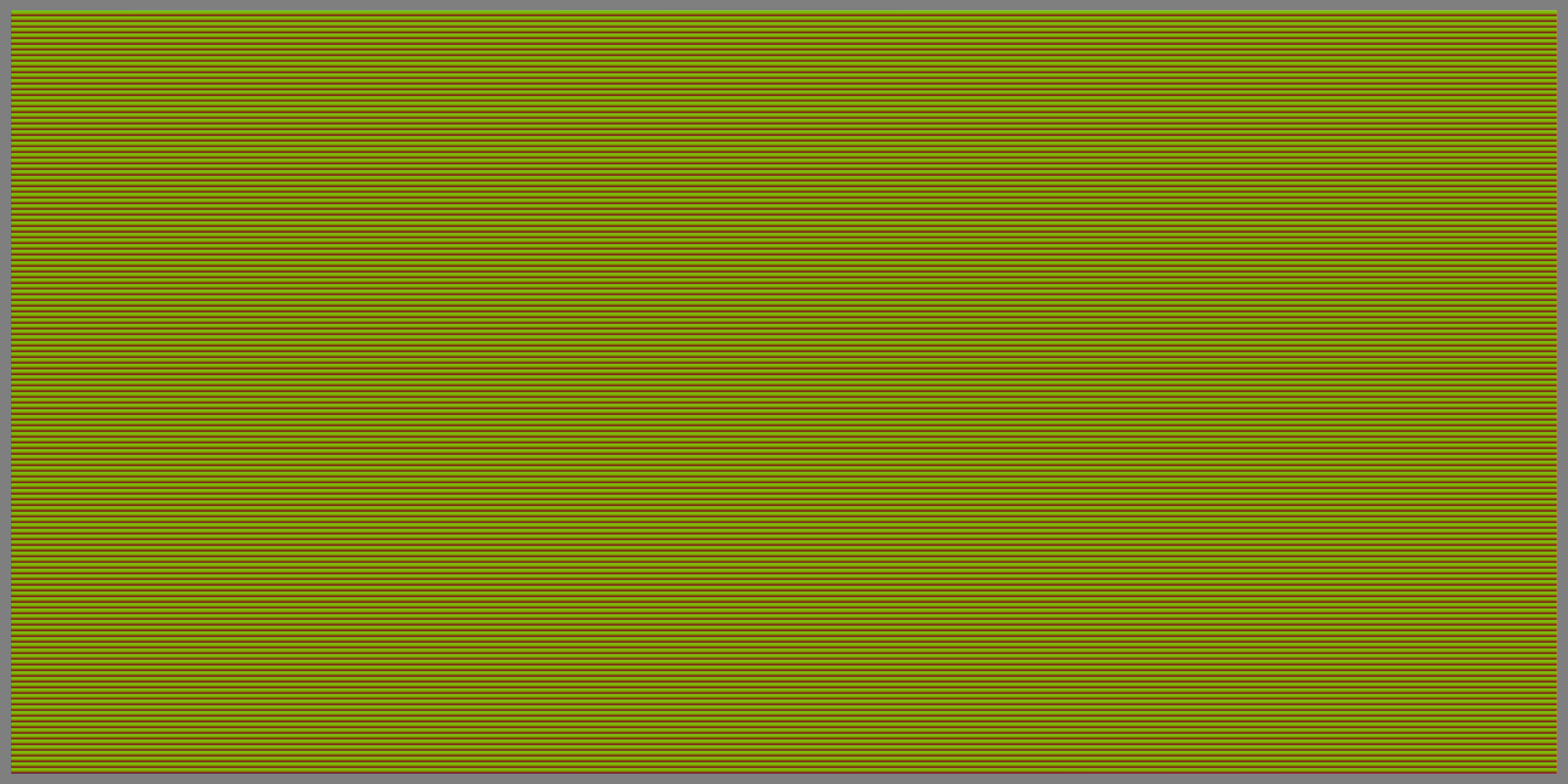

Post by pixie » Tue May 06, 2025 8:29 am
This time I baked the geometry into a normal map, what you see is just a normal map applied to a box. It might be all that you want.
