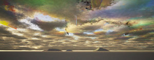

Post by CTZn » Fri Sep 26, 2014 6:24 am
I'll give more details when I'll have the chance to use a keyboard.
You will find attached an pigq with one igs linking the cloudsBoxA material.
The scattering comes with a cumulus phase function that will revert to uniform as soon as you will edit the medium (UI concerns I'm guessing). That is kind of a preview mode that works good too. HG at 0.844 is a more realistic compromise than uniform.
the shader will operate only between the min and Max altitudes, set the box geometry accordingly.
keep in mind to copycat the parameters between scattering and absorption to avoid volumes mismatches.
feedback welcome. ask questions as needed.
should look like about this
cloudsCanyons - RC1.pigq.zip
(11.9 KiB) Downloaded 444 times

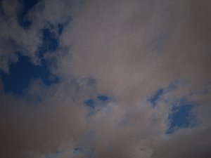

Post by Zom-B » Fri Sep 26, 2014 8:21 am
This is the slowest clouds I ever rendered ^^
on 1920 x 1440 I have 56k samples/sec per machine...
My result also look different then yours CTZn.
Here a example after 45min on 3 machines reaching 145spp:

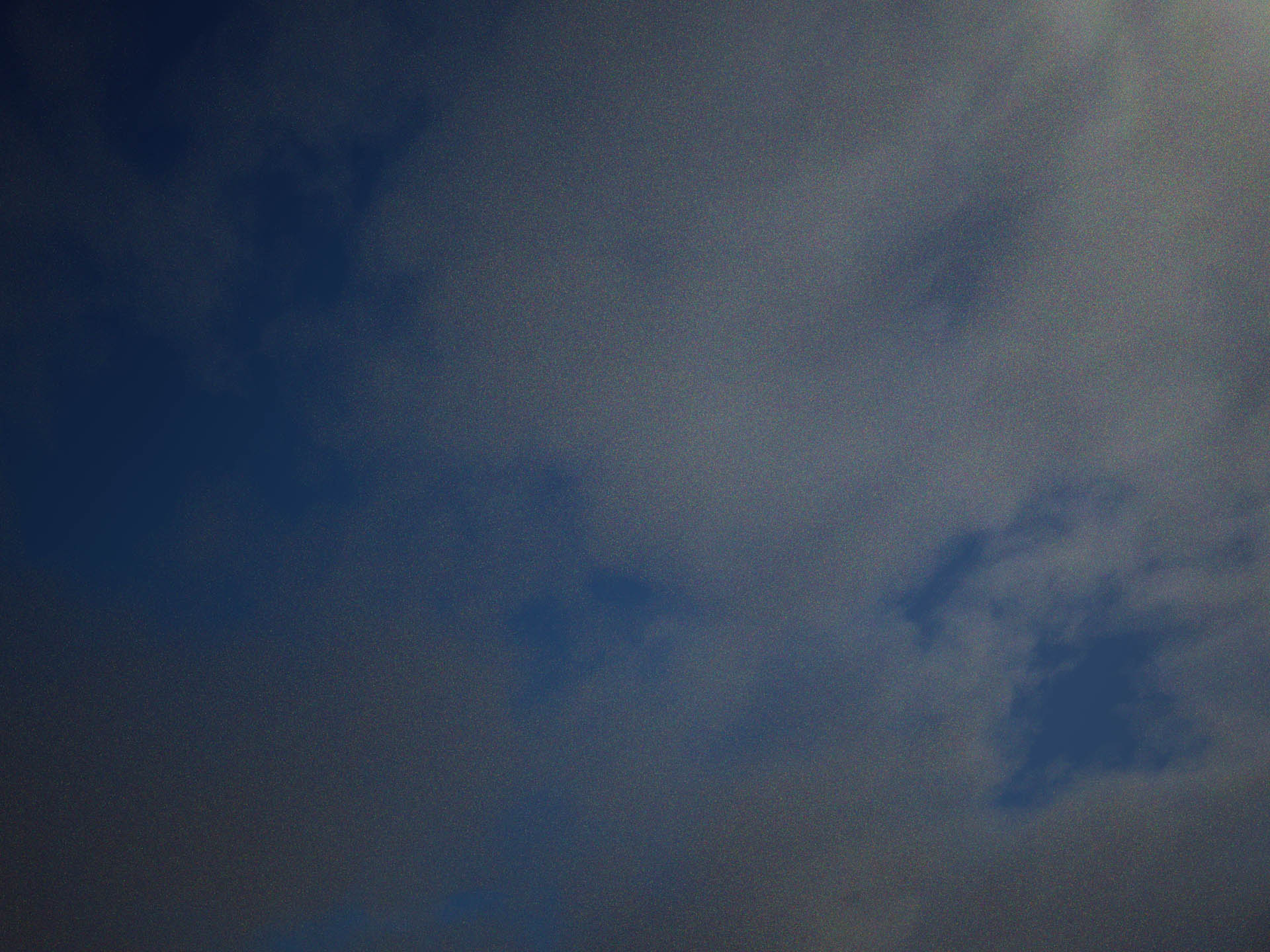

Post by kklors » Wed Oct 15, 2014 12:42 pm
Finally had the chance to play around with it.
Especially dig the characteristics scale and layer amount results. Higher scales give pretty nice results for hero clouds.
Did only some quick tests with combining different sorts on different heights and put some cauchy on some as well just to see what happens.
The only thing I noticed is that the edges start refracting sort of when they intersect. Is there a way to deal with it? One could combine all meshes to avoid intersections, but that would defeat the purpose of having different cloud types on different levels.
Attached an example with Max Extinc. Coefficient 0, as the effect happens also when they are transparent.
Re: the clouds box material
Post by CTZn » Fri Oct 17, 2014 4:31 am
Hi kklors, thanks for your time and for the pic.
Thank you for pointing the border issue out too, since I never tried several intersecting volumes I wasn't aware of it. I am supposing that MLT is favorising this behaviour but that I'll check on myself. Convergence is key, as we know :) Cauchy is in question too...
