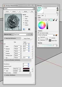

I'm creating my material in sketchup as below:
In the SKIndigo editor, these are the material settings I want:
Material type: Specular
IOR: 1.33
Displace: (A texture I've picked)
Precedence: 9
Absorption: Sketchup
In the Sketchup materials window I have the following:
Use texture image ticked (using my texture)
Size set to 1500mmx1500mm
Opacity: 3
And that all renders just as I want it.

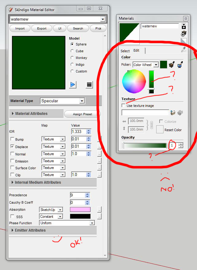

However when I 'import' this texture to a new sketchup file to test it works, half of the settings are wrong. They have now changed (bold ones are the incorrect settings):
IOR: 1.4
Precedence: 2
Absorption: Constant
In the Sketchup materials window its all changed:
Use texture image no longer ticked
Size set to 100mmx100mm
Opacity: 50

Ok, so now I'm running Indigo 3.6.18 and SKIndigo 3.4.19 and the problem is partially resolved. As before in bold is the incorrect setting when I import my previously exported material to a new sketchup model:
IOR: 1.3
Precedence: 9
So all ok in the SKIndigo material editor, but in the Sketchup materials window its still incorrect:
Opacity: 2
No idea why it won't tag the texture to the material in sketchup and why the opacity settings are going awry
Any thoughts? Theres no point in me making a material that still requires a large chunk of the set up process by the user!
I'm using version 8 sketchup and I'm loathe to upgrade to sketchup 2013, so hopefully the problem isn't to do with that.

I set up the material in Sketchup so it works as I want it:
Then I export this material from SKIndigo and save it as a .pigm
I open this .pigm material in Indigo and it all renders fine, correct settings, texture present etc.
So I think its all working ok. But when I start a new sketchup file, create my new water material and then import my .pigm material, it all loads ok and the settings in SKIndigo are ok, but its the sketchup material properties that have all defaulted - the colour is wrong, the opacity is wrong, the texture is not attached and so on.
So I'm lost
Are we thinking this is an issue with Sketchup, or am I missing a setting or a checkbox in the material editor? I've downloaded materials from the database that update all the Sketchup material property settings with PACKED_Textures etc when imported, so its certainly possible. I just can't seem to get it to work!
