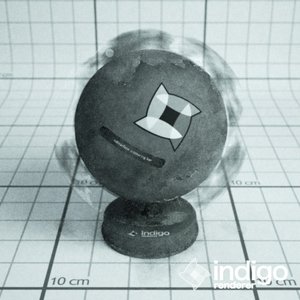

Hi baka, here is one cloudy fog material: about half of the volume is thin air, the rest is smoke.
The (identical) shaders are applied to the material's medium, in absorbtion and scattering. You can disable the absorbtion for a slightly faster rendering, and control both values by modifying the last multiplicator (50.0). Clouds scale are controlled by the 30.0 number.
Let me know if you need a different shape, I'll try to make it for you.
Here's the shader both parameters are using:
def eval(vec3 pos) vec3 :
let
	fracNoise = fbm(pos*30., 8)
in
	vec3(if(fracNoise>0.0, fracNoise, 0.0)) * 50.0
a quick render < 10mn, bidir+MLT
cloudyFog.pigm
(589 Bytes) Downloaded 450 times

Thank you CTZn, I'm gonna play around with the parameters and see if I can get the look I need.
