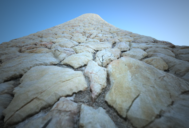

As a coincidence, I was just preparing this scene to be rendered with displacement if 1.1.1 would arrive. :). I am curious how that will turn out...

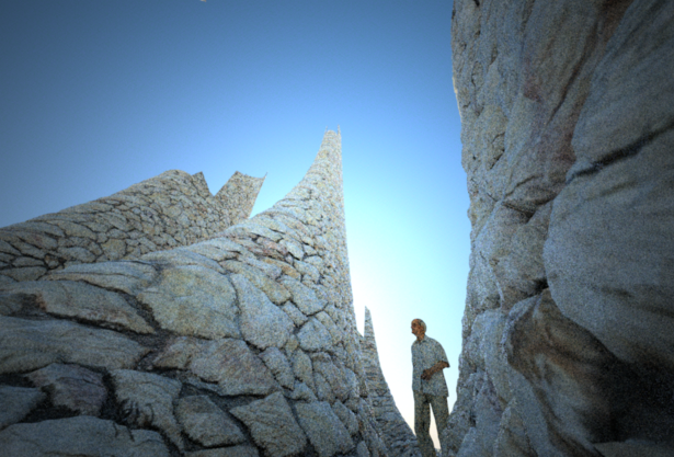

Whaat
Posts: 1827
Location: Canada
Post by Whaat » Sun Jun 01, 2008 6:28 pm
I think there were a few problems with your scene:
1) You probably didn't use Indigo subdivision. You should set the max number of subdivisions to a number greater than zero when using displacement mapping. Keep increasing the number until you are satisfied
2) The entire scene was made up of reversed faces. This completely messed up the displacement mapping.
3) The scene is WAY too huge and complex to be using displacement mapping and Indigo subdivision for the ENTIRE scene. One workaround would be to create a new material that will just be used for the rocks that are close to the camera. This material can have subdivision and displacement applied. To simplify your scene, I simply deleted about 80% of the faces.
Once I fixed these three things, the displacement rendered great!

Post by kwistenbiebel » Sun Jun 01, 2008 8:06 pm
Oh yeah, the displacement is convincing.
What values were used? (displacement, subdivision,curvature etc...).
Do we have to apply a subdivision value for each curved material now, instead of relying on the default 'soften edges' smoothing of SU ?
Thanks for testing the file.
Cheers,
Kwistenbiebel
