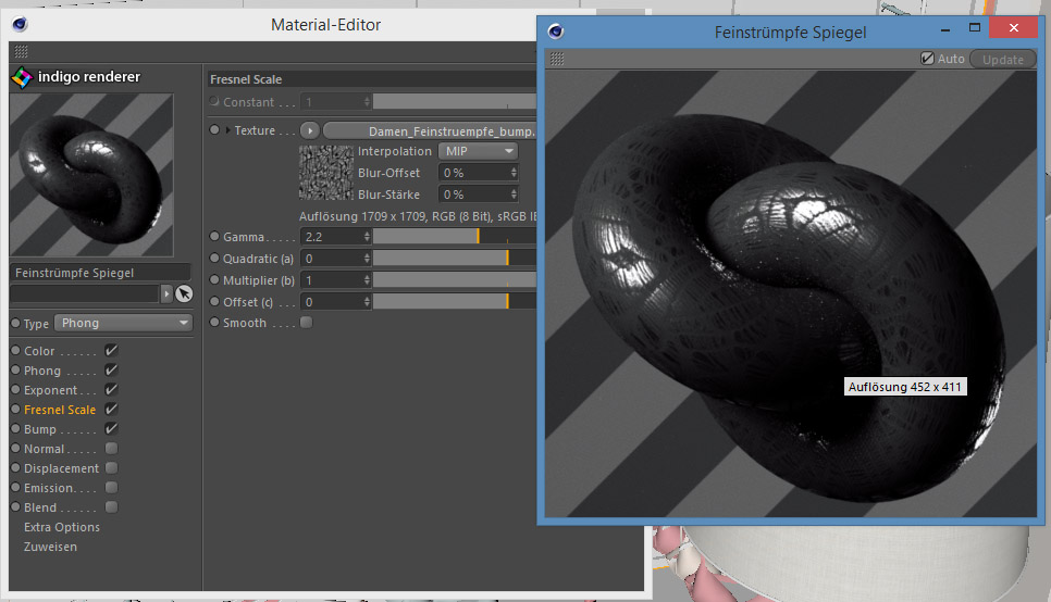

Re: Arroway Materials
Is a parameter for Phong since quite some time already, been introduced with double sided mat etc.Pibuz wrote:How it is done is the question now...
Its included in the C4D exporter since then:
As you can see, it is super powerful to control the amount of reflection using a map, I use it on most of my materials!

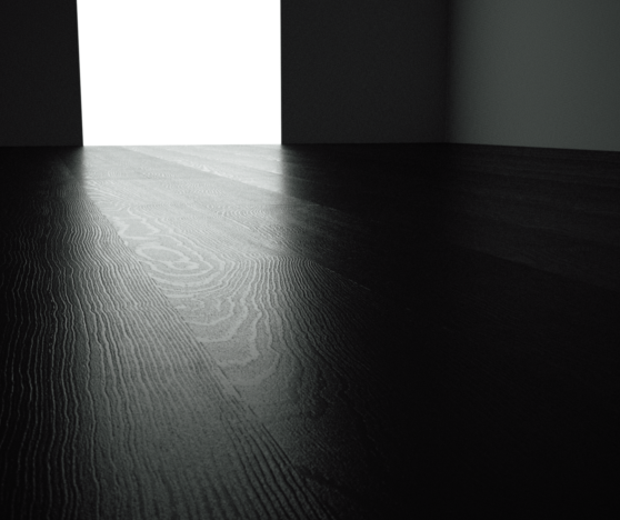

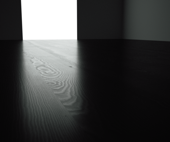

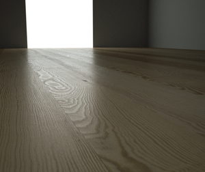

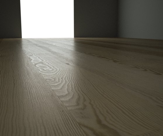

Hi,
This is the way I use to work with wood textures: An easy example would be a pine plank texture and a natural/waxed finish looking.
-First I place the diffuse map in sketchup. Verify scale of the model and scale of the wood (how long your board should be in relation of the texture). Then set the camera very close to the plank at a grazing angle with an indirect light source infront.
-Then in skindigo I set the material type to phong, ior 1,2 and exponent to 400 or so. Place the bump map in the bump channel at a 0.0004m value. finally set the albedo map to none with 20 black color and render to test. With pine the dark vains and knots are harder so shoud be the lighter parts in bump texture. I use to edit bump and exponent map in gimp/levels.
-Set the bump to none when I'm happy and work with the exponent map. With pine softer parts doesn't shine so much so should be the darkest parts of the texture. And yes Zom_b that texture works definitely better if you set it on the fresnel scale, didn't know that. So what to do with the exponent channel?. When it's ok, I check the final result with all textures on, and generaly desaturate a lot.
These are some renders of the example:
