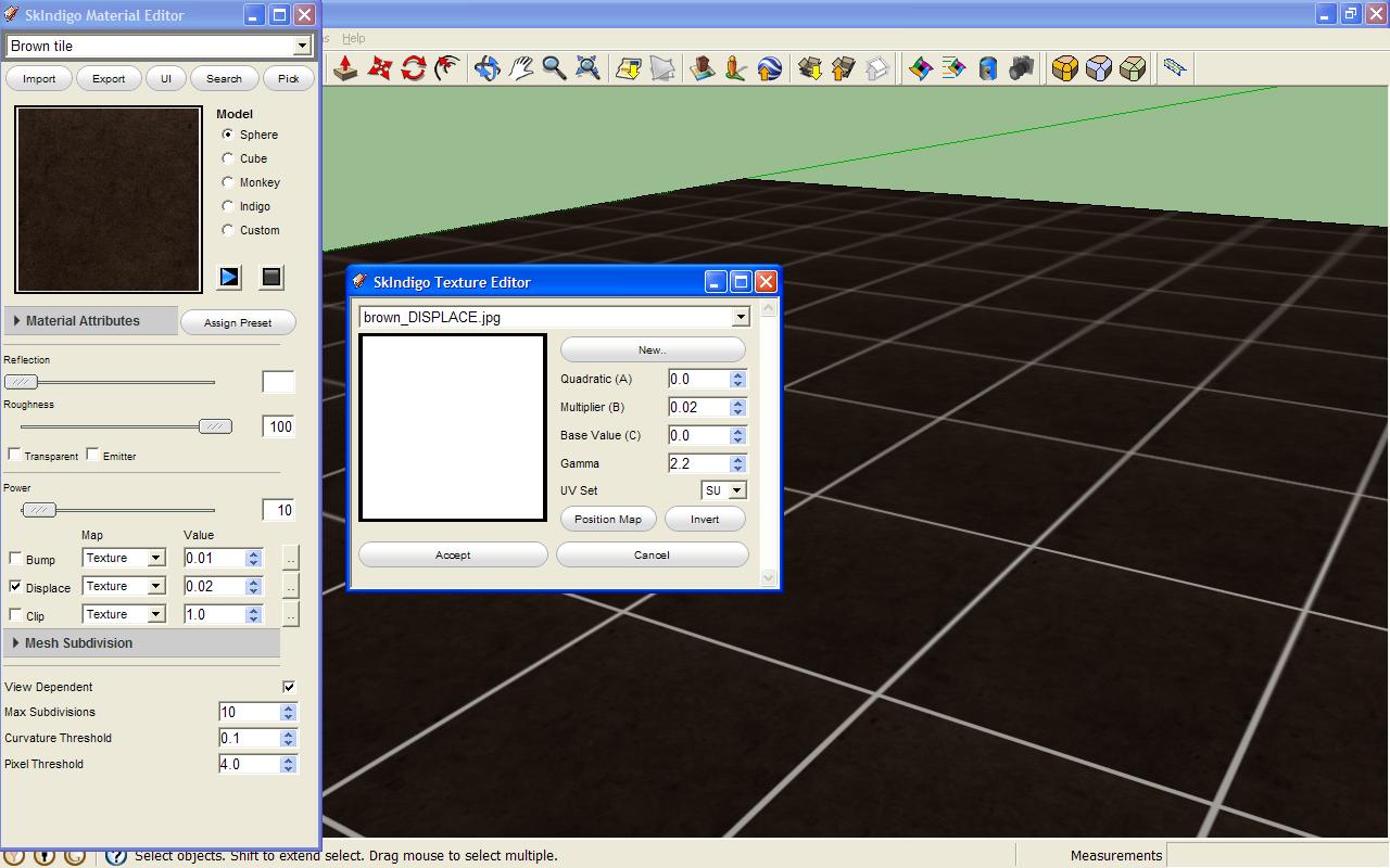

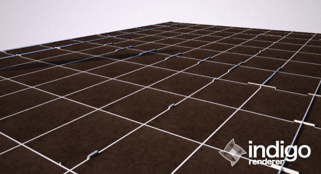

Hi to all,
I'd like to ask is there something wrong with the displacement map that I'm using.
I used displacement with other materials and this is the first time I'm using it with tiles.
Here's my screen shot and the render.also I included the material maps.

Displacement can be right..but We can't see the displacement options!
Try making a group aout of your floor, enter the group, right-click and select "edit active mesh", then set a higher number of subdivisions (should be set to 0 or 1 at the moment).

Thanks for your reply Pibuz. In my scene subdivisions are set to 10
I tried higher values like 20 and nothing changed.
I think there's something wrong with my texture jpg. Because other textures work fine

Perhaps are ther two UV sets used ? It looks like the two parameters are just not lining up. In all cases I will be of no help concerning SU.
