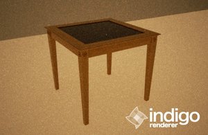

I feel like I keep missing something. I am trying to create a virtual studio. I design and make furniture and want to be able to put them in similar lighting schemes to show to clients. I created a cyclorama and a couple studio lights. When I render the scene it doesn't look right. The table in the scene doesn't seem to cast shadows and it just looks bad.
I attached my skp file and a render of the scene... maybe I am missing something?
This was rendered using Camera, with an ev of 3 and iso of 1600
The light is Preset incandescent 100w with the power adjusted to 500
Environment is off
Environment is off

Looks like your bottom surface is on the same layer as the Bulb. So it is emitting and hence no shadows on that surface.

I'm sorry, I used the word Layer when I meant Material.
Material: How the object looks/acts when acted upon by light.
Layers: Used for lighting. For example, a material on layer 0 will be lit by light on layer 0, but not layers 2 or 3.
Chances are you won't need to use light layers right off the bat, or at least until you've mastered the other parts of Indigo.
So, you make an object in Sketchup and apply certain material (in Sketchup) to the object. You can then open the Material Editor from the Skindigo Toolbar and tell Indigo how to 'translate' those materials when you render the scene. Your issue was that the 'floor' was the same material as the Bulb. This caused Indigo to think the floor was also an emitter.

When you duplicate a material in sketchup, it also duplicates the material in Inidgo. So what I do is make sure to name each material well. For example, Floor, Bulb, Table - Wood, Table - Glass, etc. I don't apply materials in Indigo until I am ready to start rendering. That was I know each material had no Indigo data associated with it before I assigned it something. I'm guessing you probably just accidentally painted the floor with the bulb color on accident.cholme wrote:Ok... even for a rookie like me, that was a pretty rookie mistake.

You have to check every sketchup material in indigo material window too. Often happens that if you create shiny white plastic, and after that for example you want to create white paper material witch should be diffuse. So if you check your new paper material in indigo material window, it probably is also phong as your previous material. So you have to switch this new material manually to diffuse. And another thing I noticed in your scene: You left sky and sun turned on, and hided them just with box around your scene. But probably faster is to forget (delete) the room around your subject and turn Sky and Sun off in Skindigo environment settings. You also have to check "Black" to use as your environment.
