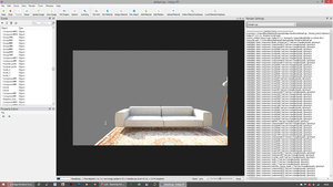

Actually I was rendering properly, then I ran the "Cleanup" in Sketchup, and "cleaned the cache" through Skindigo, then the problem appeared.

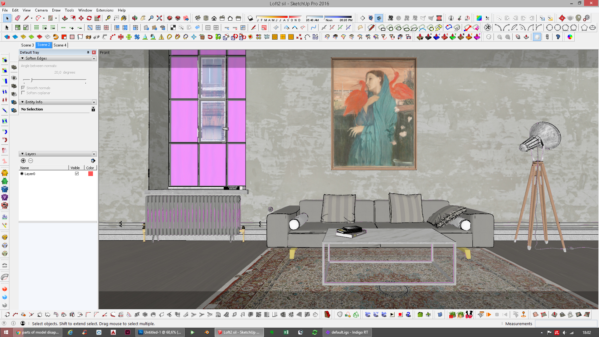

In the render log it says "....had zero triangles/quads, ignoring it." for the missing components. On the other hand, I can see the components in the "scene" but they are not rendered.

Actually I lived this problem before but I ignored it. The only solution I was able to find was exploding the component, but now, nearly 90% of the components are not rendered, so I am not able to explode all and remake components again.
Checked the layers, there is only "layer 0" and all components are on that layer.

Render before "Cleanup"
Components exploded
