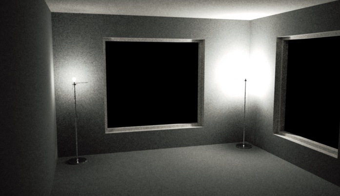

A tutorial on this subject is would definitely be helpful. I have attached a sample SKP scene that should help a bit.
40W (500lm) and 200W (3500lm) bulbs
EmissionScale.zip
(131.22 KiB) Downloaded 1203 times
